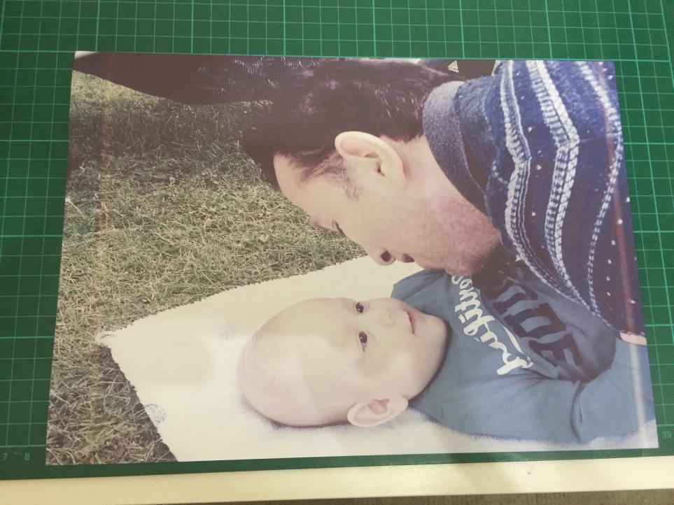

Hi All,
Bit of a strange one here - trying to print a full page photo to sublimate ...
But I am getting lines near to the font and end of the picture.
See attached picture for reference,

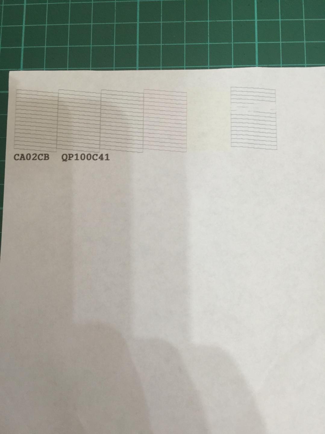

Now I have been battling with cyan to try and get a full nozzle check but keep failing to get a full cyan output.
See picture for a nozzle check report, cyan is almost complete but I can never get it full (But it did use to be) Even after mutiple head cleans and also syringing cleaing fluid through the cyan print head this is the best I can get..
(Cyan is far right, looks darker on a picture..)
Would having that not full give me the problems i am experiencing in the full page print out ? Why only at the begining and end ? In the middle it looks fine so if the head was blocked wouldn't i be getting lines everywhere ?

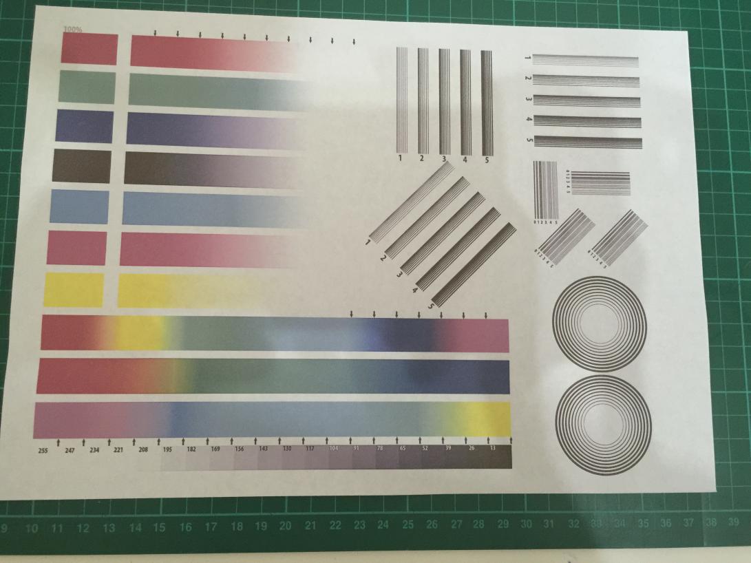

I also printed out a test chart and that look ok too - see picture below ..
Could anyone shine any light on this issue ? It is very annoying !

Thanks for the reply - sorry that image had not been pressed, it had just come out the printer ..

The last picture attached I printed after the first one ... and that shows no banding .. Though it isn't a full page print as such.

which way were they printer down the page or across it

Printed accross the page .. so its almost like as soon it gets to that bit on the page it doesnt print anything at all .. or very faintly thus causing the banding ...
