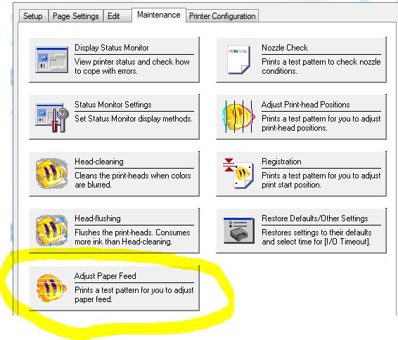

run the paper feed calibration

Sorry for my ignorance, do you know how I do that?

It's in the printer settings under maintenance, see the banding on the fish:-

Ye paper feed will sort it. It tends to stay fine for a while the suddenly get worse. But paper feed has always fixed it

The printer is 2 years and the paper feed has not helped the issue.
Spoke to Ricoh and they won't send engineers out for this machine as it uses Sawgrass inks. Spoke to Sawgrass who were no help at all.
Not sure what else to try, does it mean I just have to buy a new machine?
