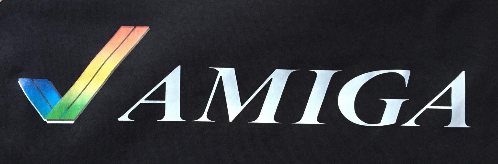

Well I decided to do a test using my OKIC841 and White toner Printer. There is some cracking and a registration issue.

Photo 25-10-2015 11 33 53.jpg (96.4 KiB) Viewed 430 times

Looks good, Cannot see the cracking.... Registration is a little bit of a problem. What I have seen on some videos is to contract the white layer in Photoshop a few points smaller than the colour layer so there is no bleed through of the white.

Thanks KathG. I followed a video guide by TTP on youtube.. I did contract the image but only by a 3 pixels.. instead of the 6 on the video. Don't really want to contract the white ink too much.
The cracking is visible on the colours.. do I need to use a lint roller before applying?
I will do some more testing on the registration by
Printing out a box outline on my colour printer
Print it on the white printer using the Black only..
It may just be that I need to move the red layer around by a few pixels..
