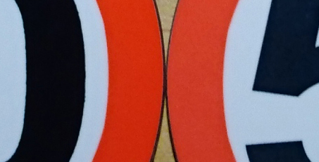

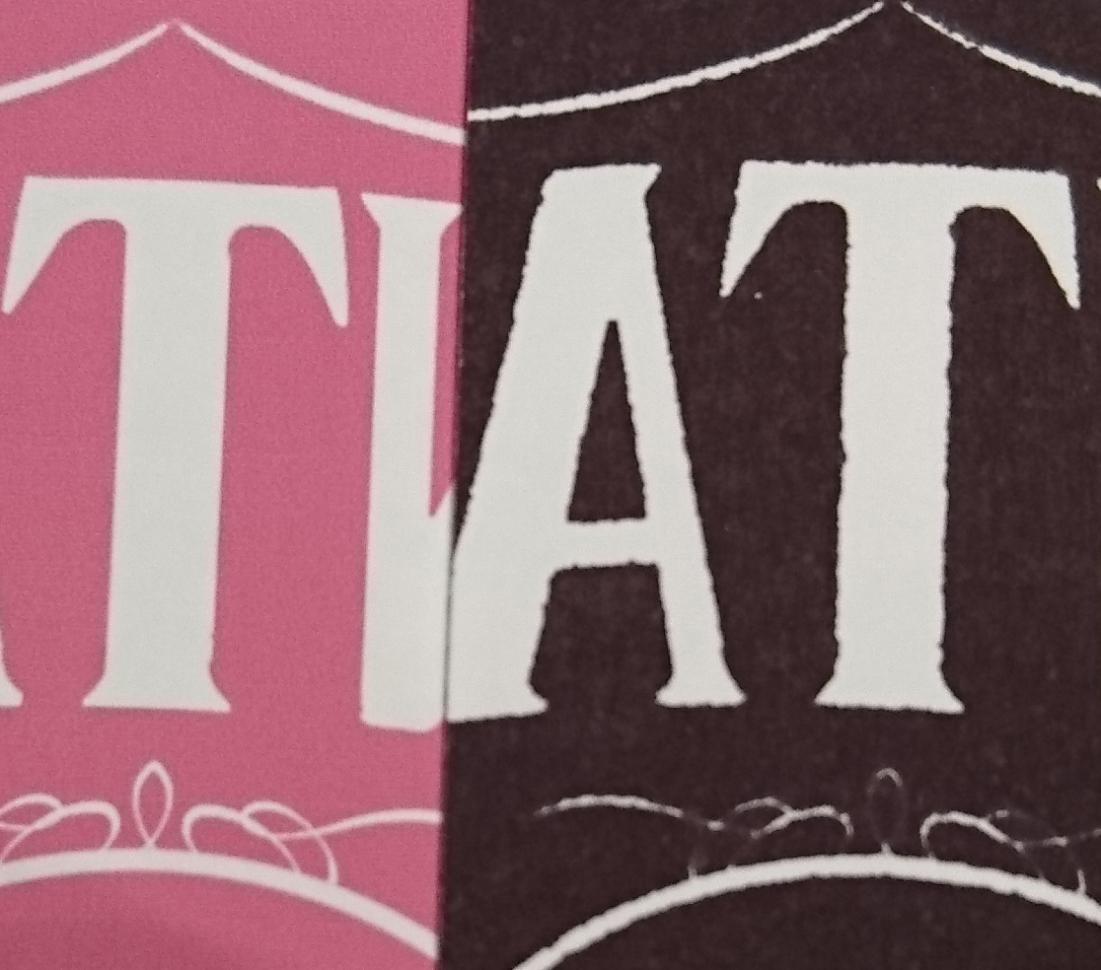

Pink and black image below is printed with the magic touch’s own paper. All colours are sharp and vibrant when printed and pressed except for black which has a rough edge to both print and pressing. Red and black image below is printed on jet stream f35 paper. The left image is printed with magic touch paper and right with jet stream paper. All colours (including black!) printed with jet stream paper have clean edges when printed and pressed but all colours are noticeably weak and lack the vibrancy/strength of colour that is present when using the magic touch paper.
I’ve tried every combination of heat and pressure (and wasted about 20 blanks) but cannot improve the results. In fact results are pretty consistent across a wide range of temps and pressure.

Printing with Sawgrass SG400 using powerdriver in Photoshop and pressing hardboard coasters with Adkins 38x50 press.

I've noticed that the MT paper can come out a bit wet on the black ink so I made a new ICC profile for the MT paper. Your ragged edges on the MT paper are due to too much black ink.

Turns out it was a paper issue. The Magic Touch paper which I was using was not absorbing the black ink properly. Must say they were great to deal with and when they discovered the problem they replaced paper with tex paper which works great.

TMT Tech guys tested my print file and confirmed they have a faulty batch of their own brand paper. Print works perfectly for them and myself with the tex and truepix papers.
