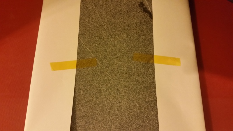

There should not be a need to have tape anywhere near the print side, I use one piece of tape to secure each "flap" to the back just to locate the paper before turning over to press. To prevent rear tape marks you could insert another piece of paper underneath the flaps. There is another thread on this issue somewhere with pictures but can't find it at the moment so worth a search.

As said above, keep the tape away from the image.... only need to tape it on the back of the slate!
If it's leaving marks on the rear I would overlap the paper on the rear, then tape, dont think marks on the rear would be a problem though!

2015-12-20 17.58.48.jpg (97 KiB) Viewed 190 times
Re: Heat tape marks on photo rock slate after heat pressing
Quick spray with isopropyl gets rid :-)
