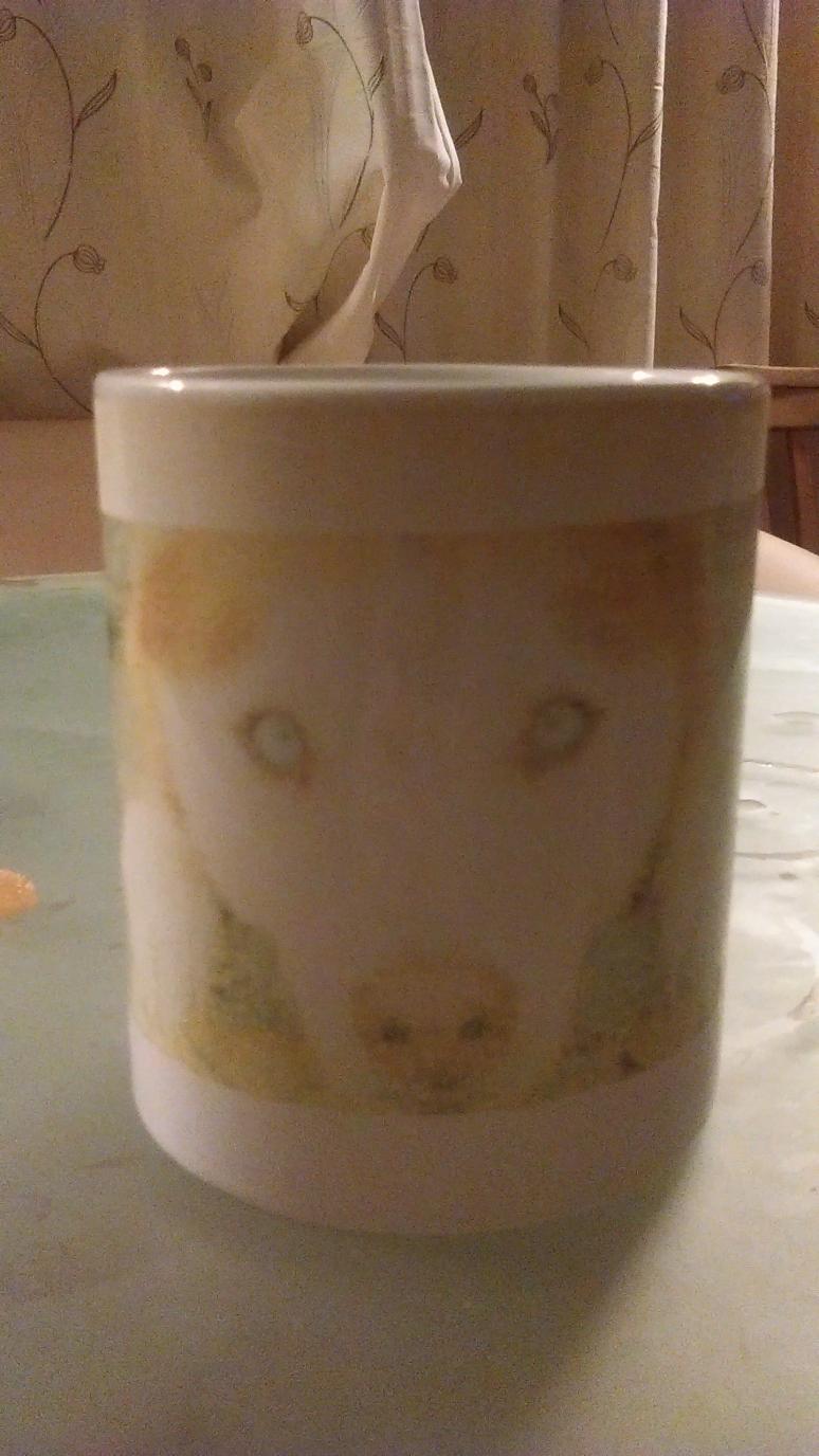

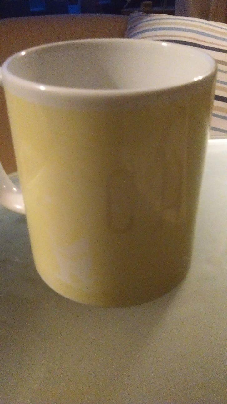

As a beginner I have been reading your forum for about 2 weeks so have bought a ricoh g3110dn subli ink also have an Epson workforce 2650 Inkjet(non genuine but tried with genuine and had the same result) trying to do some mugs but no success after all truepix,bms and another 2 kind of paper on different temperature on the heat press etc and nothing they are coming out as a yellow/green color but picture on the paper is perfect(same thing with t shirts).What am doing wrong?I suppose it`s the printer but I don't know what else to change tried everything from your forum and others...please advise

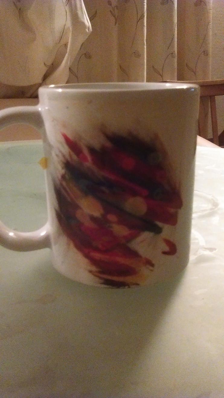

The ricoh has sublijet r in, Epson I keep it on normal inkjet.this is made with ricoh sublijet.i ve put a few drops from the subli refills straight on the paper and it came nicely on the mug but when I print something it wont come on the mug.

It`s a multifunctional 8 in 1 heat press and I tried all the time and temperature that I found on the forum.the one with the dog has beed in at 204c for 360sec.ive pre heated the mugs as well although didn't need as the temeparature dropped only 2c when I`ve placed the mug.as for the printer settings I am using a conde icc profile.can the mugs make so much difference as they are 1pound mugs from ebay?or the subli ink I am thinking maybe not the right consistency?i don`t know....
