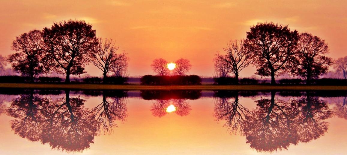

I am using Creative Studio Print & Colour Manager. The image on the computer screen is bright and colourful but when I print it onto TexPrint-R is dull and lacking colour
