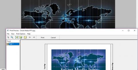

Hi,
I am having problems with my final image before printing ( Attached screenshots )
When I use custom ICC profile (Cityinks) the image changes purple/blue, when I change Printer Profile from ICC to Adobe RGB (keeping all other settings) it's perfect on print preview but prints very dark.
I have read on here Cityink ain't the best inks or there ICC profile service, can this be the problem?
Just to add paper from Natureinks & Epsom WF2510

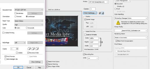

OK open your image in photoshop as an rgb image (edit - assign profile - adobe rgb (1998)) and then select view - proof setup - custom and select your icc profile from the drop-down list with the correct rendering indent
Then select view - gamut warning the out of gamut colours will show as grey patches.
This should show a soft proof of the image with your profile applied.
I would really suggest you get the monitor calibrated as many people have it set too bright. I am not sure a television is going to give you the best results it would be preferable to use a monitor. Even the most basic monitor calibrator is better than nothing.
As a stopgap you could turn down the brightness of the screen to match the printout and then adjust the brightness of the image to suit. But it will be a bit hit and miss.
