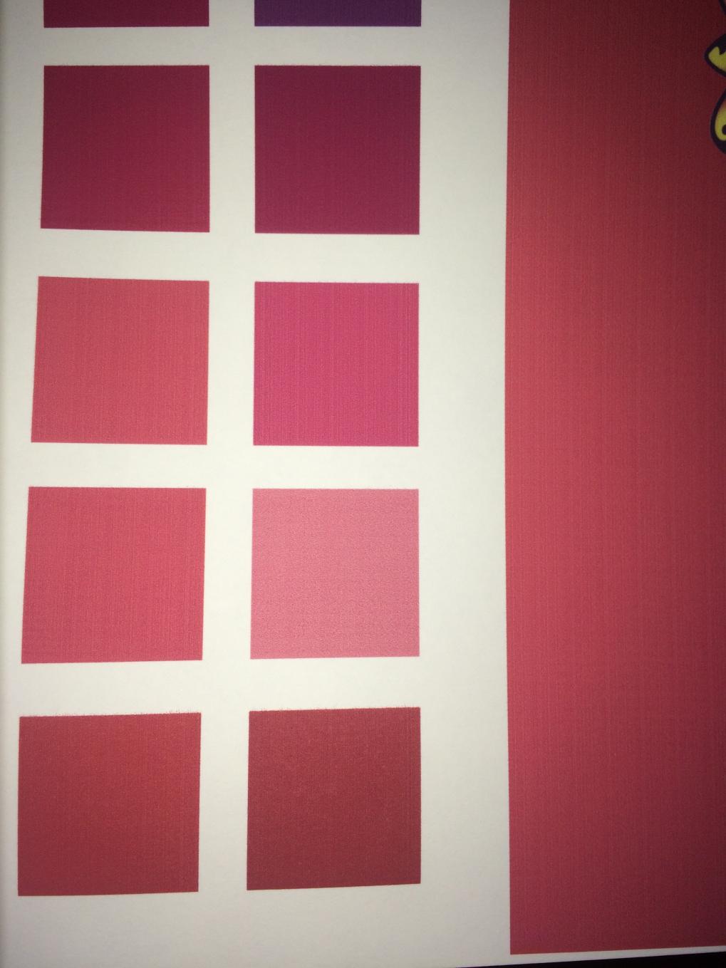

if this is true, why is it not heating onto the mug as black?? it is brown on the paper, stick it in the heat press and it comes out brown.
whatever is on the paper is what is sublimating onto the item...
the company i got the ink from had a guy phone and he took over the computer and seemed pissed i was using a mac because he didn't know how to work them (guess what? they're not much different to windows pcs...). so that was a bit of a waste. he did think it was the paper that was the issue (i was using the sample sheets that came with the package).
so i ordered true pix paper (he suggested this brand on the phone, although i was going to buy this brand anyway). the paper came and the printing was worse, lots of banding, although it did print black. i again searched the net and this time found a video from sawgrass about setting up a document preset in photoshop, along with the printer setup. so i followed this through and printed the same pics as before. success! black on the paper AND the mug, colours are vibrant.
however, now another issue has appeared... there are small lines across the designs when printing any shade of red :frown: (edit - photo added) i printed the same design onto the sample paper i received and the lines do not appear, so it seems the paper is the issue this time. anyone any advice on this issue?! it seems like i am getting nowhere, just going round in circles :confused:

the banding looks like its an ink issue, the ricoh is very sensitive to the ink and if the ink is too thin it wil cause this issue. In the past many suppiers say they have ricoh gel ink when infact they rebadge epson inks and sell as ricoh. Ive seen inktec inks rebranded as ricoh inks which is complete tosh. Ricoh inks are around 2.5 to 3 x more vicose than Epson inks so are designed to sit more on the surface of the paper than epson inks do. If you use a thinner ink the head starts to dry and the ink will not flow as fast due the the lack of viscosity giving issues like banding .

mags1892;116551 wrote:the banding looks like its an ink issue, the ricoh is very sensitive to the ink and if the ink is too thin it wil cause this issue. In the past many suppiers say they have ricoh gel ink when infact they rebadge epson inks and sell as ricoh. Ive seen inktec inks rebranded as ricoh inks which is complete tosh. Ricoh inks are around 2.5 to 3 x more vicose than Epson inks so are designed to sit more on the surface of the paper than epson inks do. If you use a thinner ink the head starts to dry and the ink will not flow as fast due the the lack of viscosity giving issues like banding .
thanks Mags. I've thought all along it was the ink, just really needed to be sure. The seller won't admit it's their product's fault, of course, but I will continue to hound them!!
I also wondered if it was the printer, but it's perfectly fine other than these lines!!
thanks :redface:

Been there when we were developing ricoh ink we first started with epson formula and had the same issue with some 3110s . So we bought sawgras inks and tested the viscosity and redeveloped our inks to be around the same viscosity but trying to keep some f the benefits of the other inks like cleaning agents and binding agents etc. Took us a long time ti develop but we now have a very nice ink.
