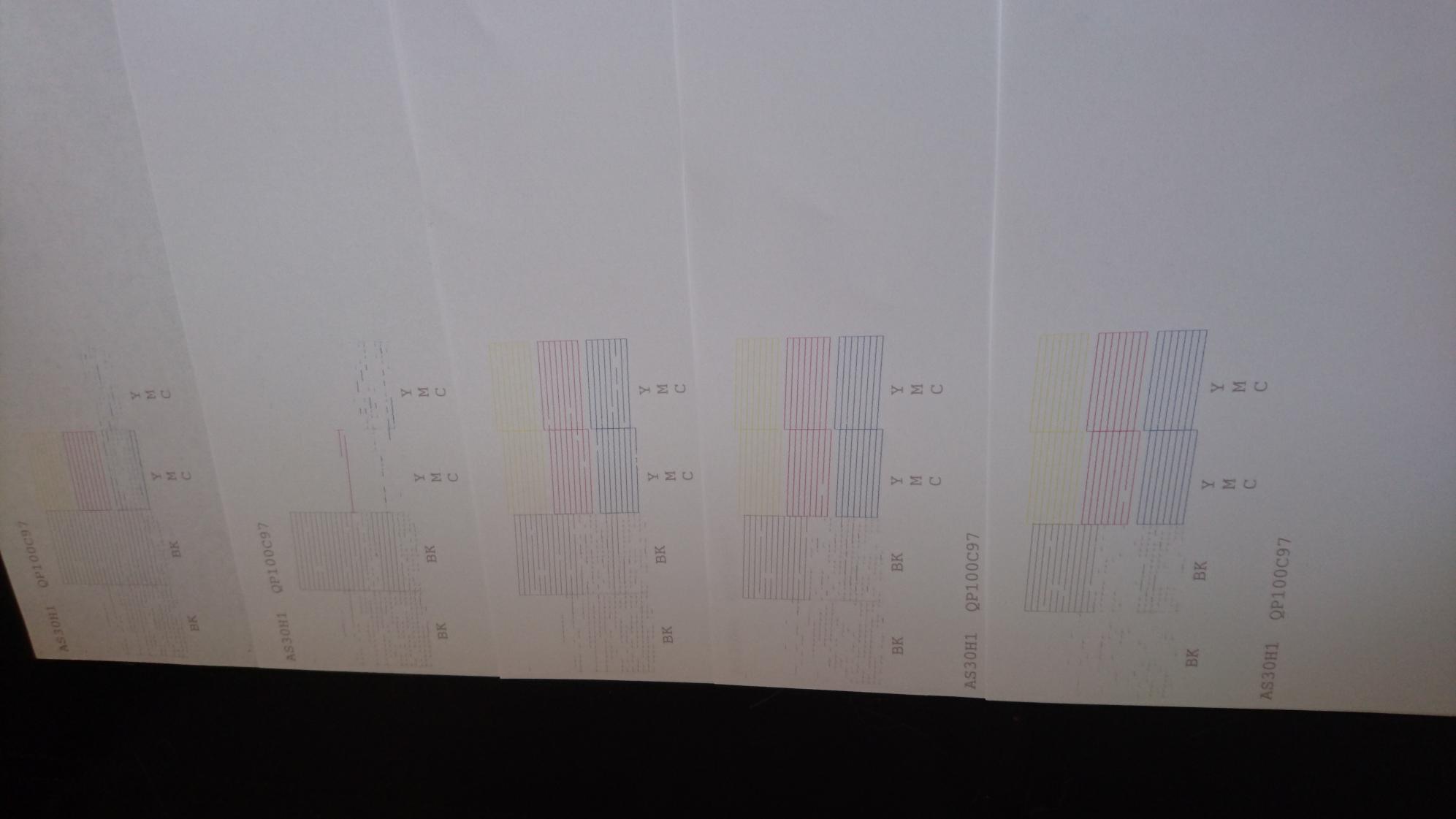

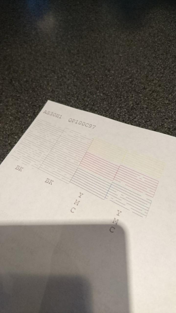

Got a WF7110 bundle from CityInk in an attempt to fix a horizontal banding problem with my Ricoh.
Unfortunately the thing is a heap of crap, for lack of a better word. Ive had it set up for a week and haven't managed to get a single perfect nozzle check out of the poxy thing apart from when I initially set it up, ive done ONE test print which came out streaky with horizontal banding.
Ive done close to 30 nozzle cleans (Im aware doing more than 3 is never recommended but what other options do i have?)
With every clean i do, the results get worse and worse.
Image attached for your viewing displeasure

That's the inks not the printer I would say. I have a 7110 on long term test with cheap inks in. Switched on after 6 months, single head clean and prints spot on.....if not very slow!

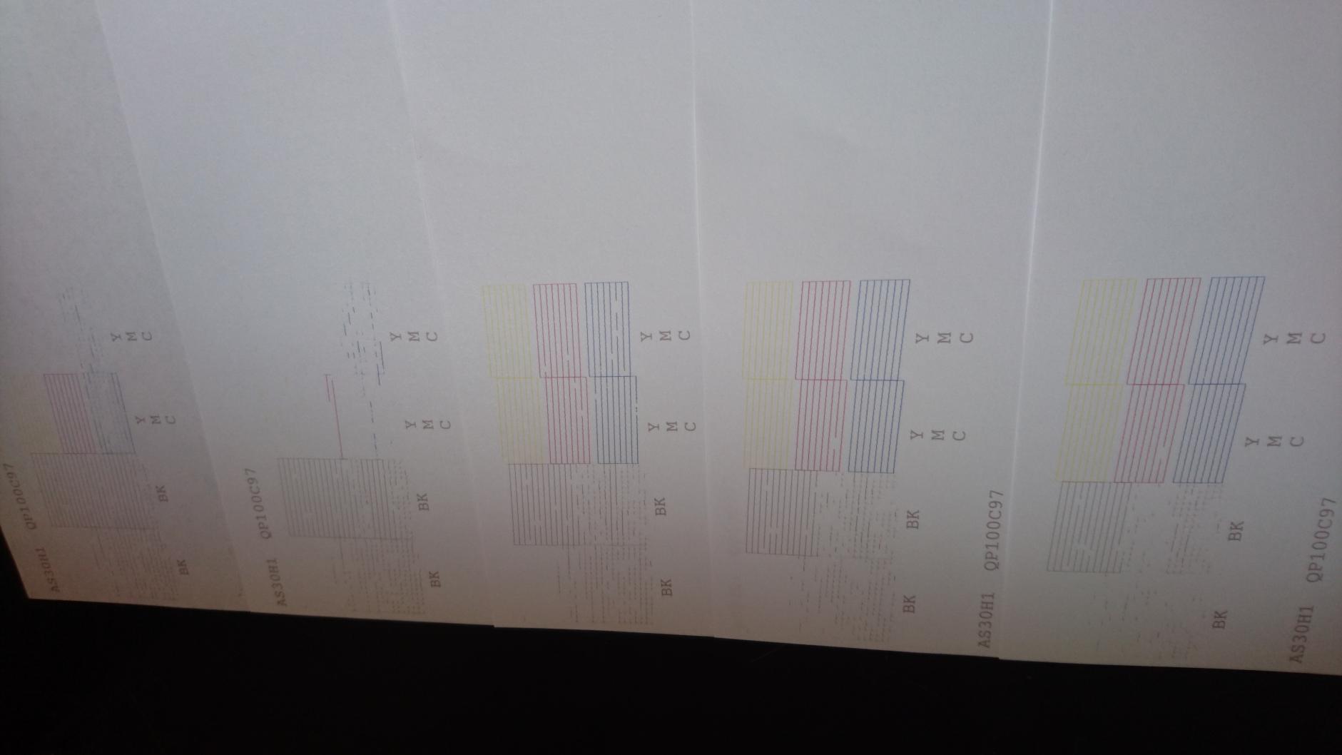

Just done more nozzle checks, black is looking terminal but colours are slowly getting better...
[ATTACH=CONFIG]4534[/ATTACH]

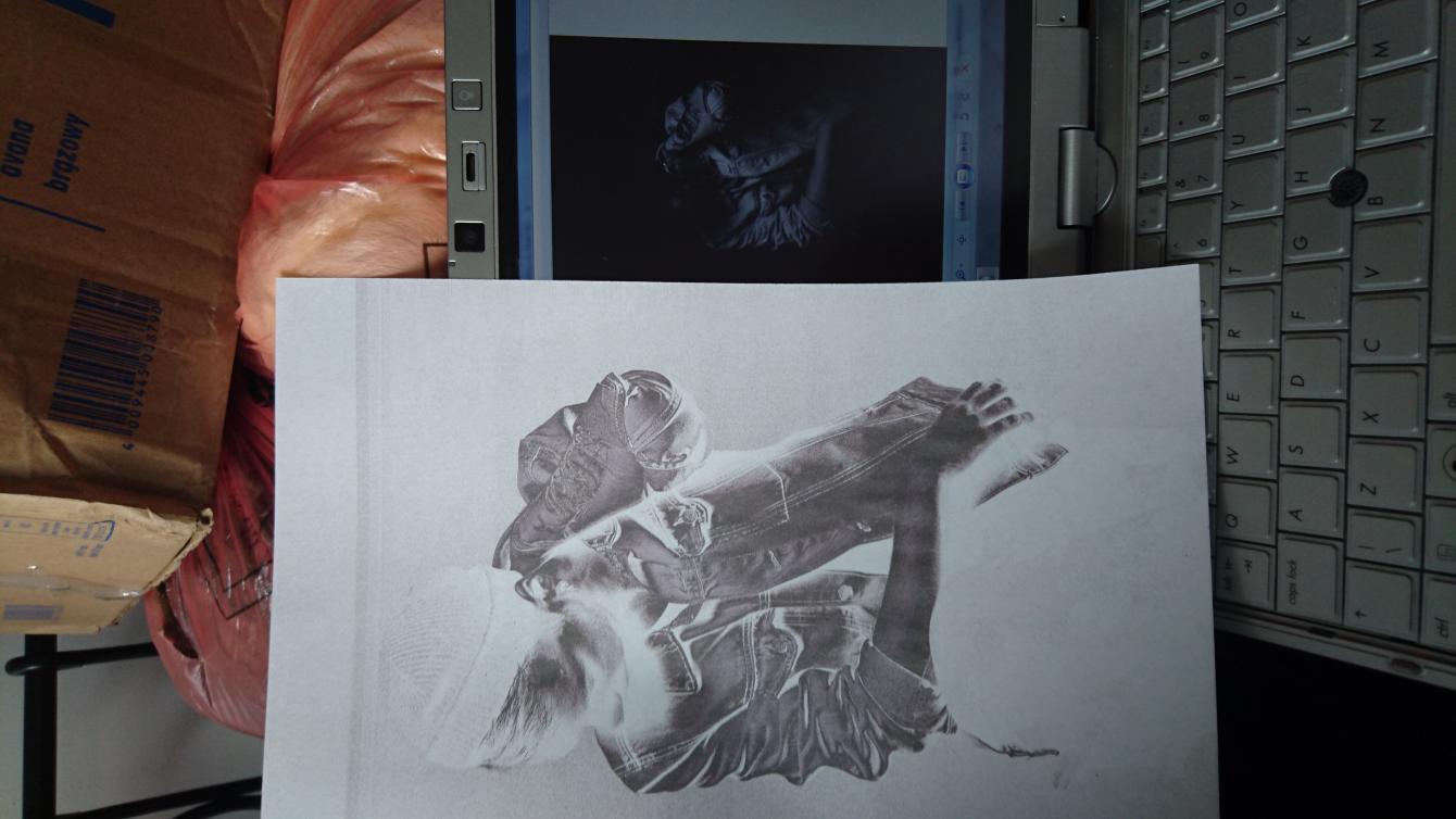

Complete print head failure now, tried to print a random black image from the Internet and got the attached image before the printer spat it's dummy out and now thinks there's no ink cartridge in it
