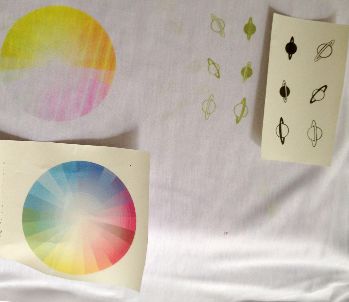

Wondering if you had any advice....Bought a subli-kit from City Ink Express
I've printed to their sub-paper....looks fine on paper.
After heat press it transfer (via HPC480 heat press from Signzworld)
190C for 60Seconds
onto gildan polyester T
the result for black is yellow/greenish.
Any ideas why this is happening?
#disheartened :frown:

Not being funny here but your 'black' transfer prints look green to me.
Is your ICC profile set up correctly? What software are you printing from?
I've heard of green blacks being a problem before with Epsons.

The graphic comes black on the paper but when heat pressed is pale green/yellow.
The result of the colour wheel(which I downloaded from google images) test transfer failure is very disappointing too.
Re: black print on paper turns out Yellow/greenish after heat press!
Looking like the cyan head is blocked. There's also some terrible banding on that colour wheel.
Have you done a nozzle check?
Does seem like the Cyan is not turning out after the heat pressing despite it looking OK on the sub-paper.
I've run a nozzle check and there was a slight break in the magenta only. I've since cleaned the heads.
Have you tried sublimating a different product: mug, aluminium sheet, coaster, etc?
Also, is there any possibility the cyan ink may not not be sublimation ink?
I've only got T-shirts. There was regular ink in the printer before. Maybe I need to purge that out?... I'll print some bands of CMY&K. ......IT SEEMS TO HAVE WORKED! :redface:
The black does have a dark green tinge though upon closer inspection.
