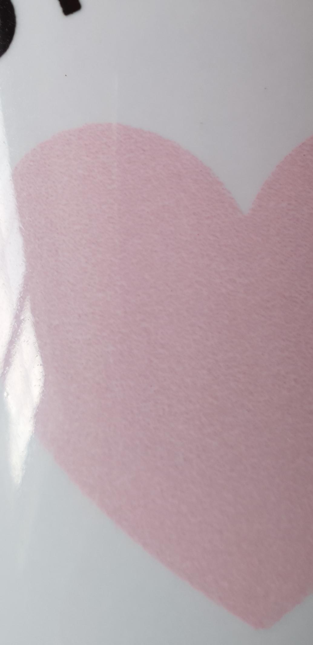

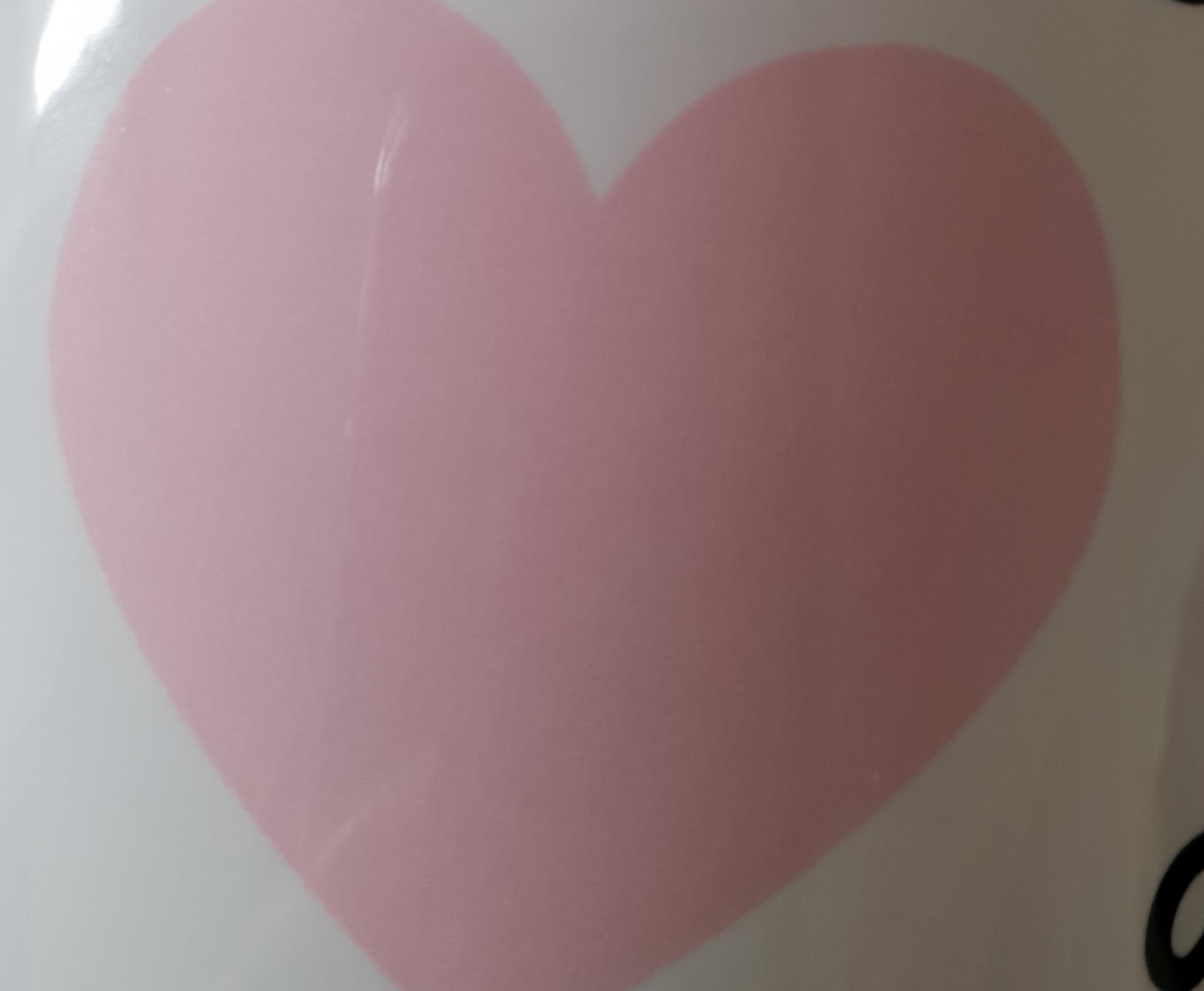

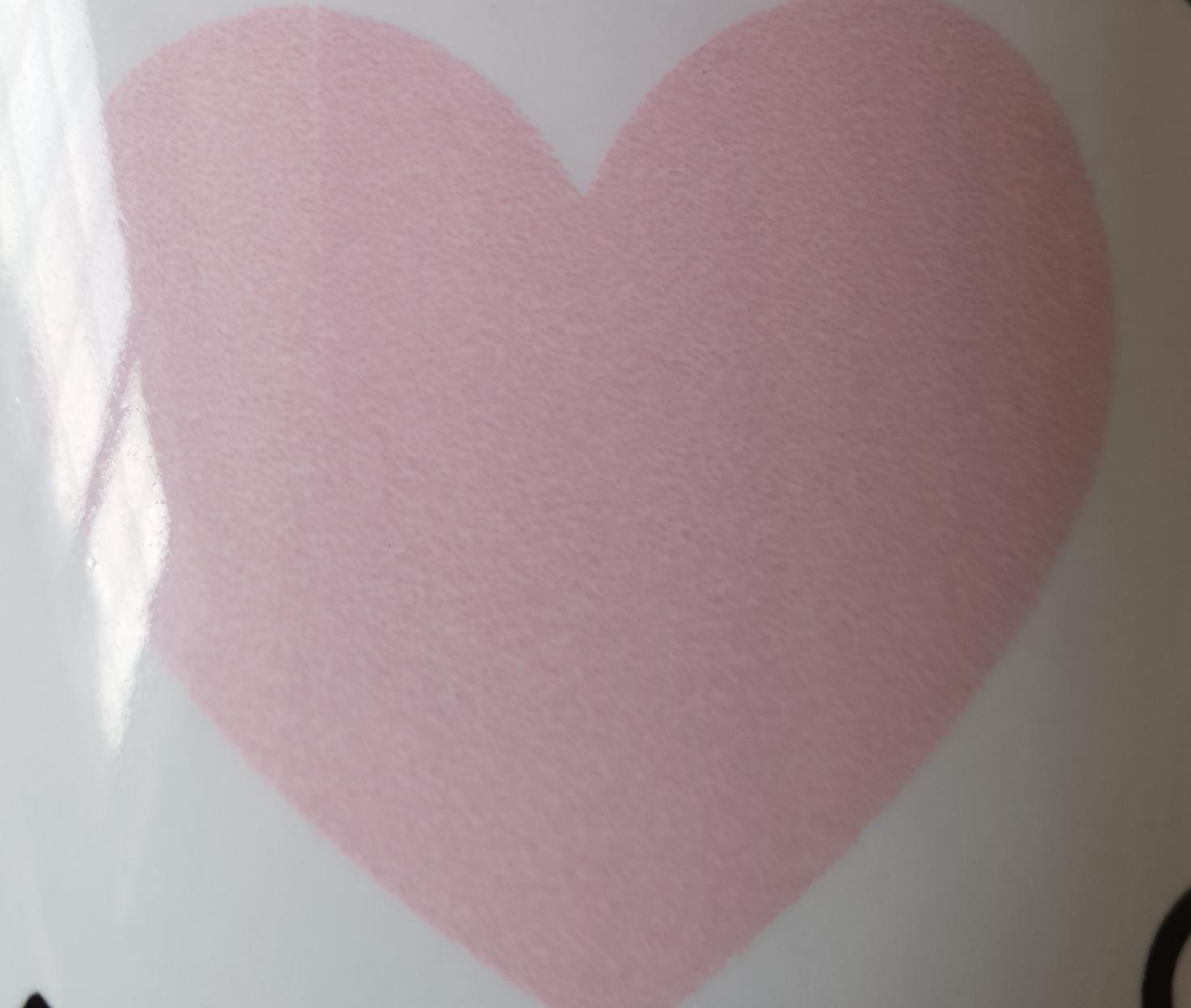

I thought I'd just add 2 photos:Ljb596;132853 wrote:Just tried printing from Illustrator and it's the same. To be fair it isn't bad and when it's pressed it's acceptable and I would send it out.
But when I send the same file to a print on demand company, it's much worse and I wouldn't want it to go out to my customers.
The colour from print on demand companies is also lighter. It happens on pale colours that come out even paler with a few print on demand companies I've tried. Do you think you can just go too pale?!
Top- dotty, printed by a print on demand company
Bottom- fine, printed by me
Both the same file.
I'm so confused!!

I would blame budget paper and maybe the ink. It's bad quality printing, who is the POD company?
