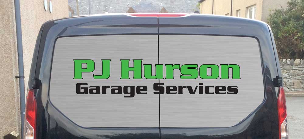

This the graphic I'm proposing, it will be a single piece print and cut (laminated) so as mentioned above I guess just slitting down the middle and wrapping slightly over the clean edges will suffice.
I tried adjusting text etc. but nothing is working for me.

Don't rely on the outlines for the panel size. I would do a paper template of the rear panel. Print the whole image as a rectangle and then use the template to cut to shape. Alternatively if you have wrapcut or similar you could use that.

Yes, that was the intention, this is just to show to the customer
