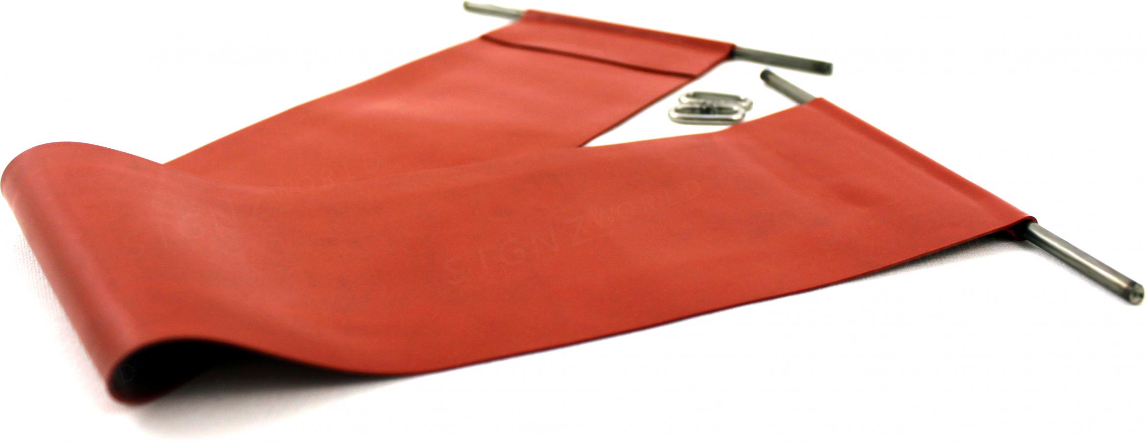

So i can find the silicone no problem, wraps I have look like they are attached to the end clamps/clips with studs, that shouldn't be a problem. Now, the clamps on the end, I'm thinking something simple as used on the wraps shown below would be easiest option (but open to any other ideas) No idea what to search for though :-)
These actually looked glued together so that could be even easier. Looks like metal rods with small oval clips?
