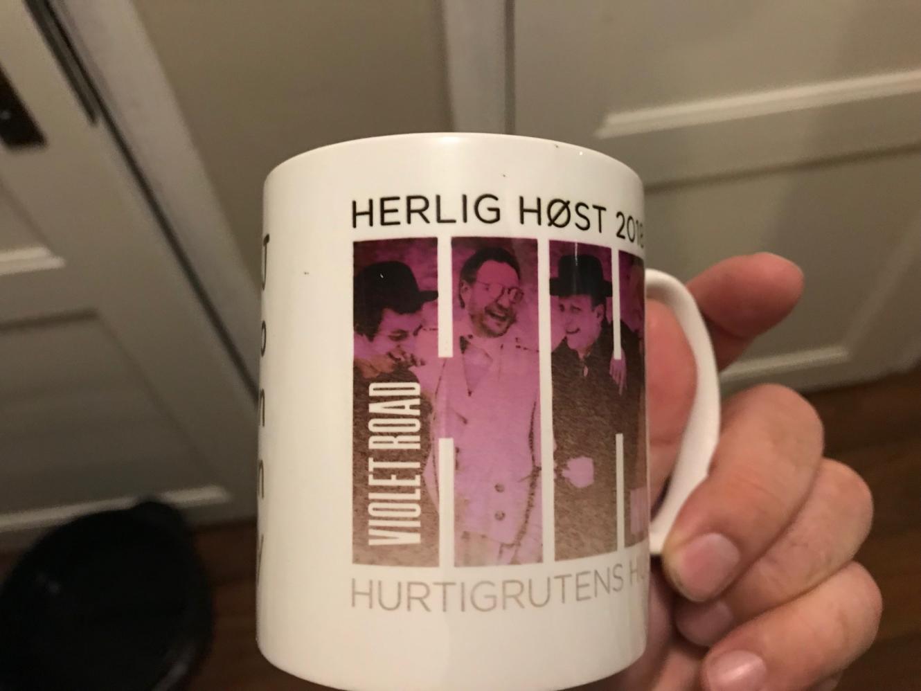

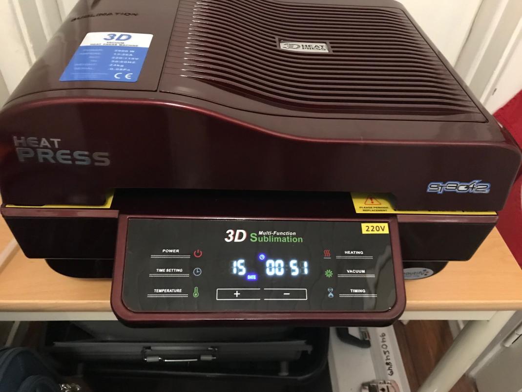

I am new at this and today I try my 3D sublimation machine for the first time :)
I am using an ST3042, and today i was sublumating a cup with a picture.
It seems to me that the picture is clear and nice in the top of the cup, but not so good in the bottom....
What could I do wrong ?
I use temperature 195 degree celcius and I try both 8 and 9 minutes......
Anyone ?

It seems you turned on only the top heating element and not the bottom one as well. You need to press the “heating” button twice to turn on both.
