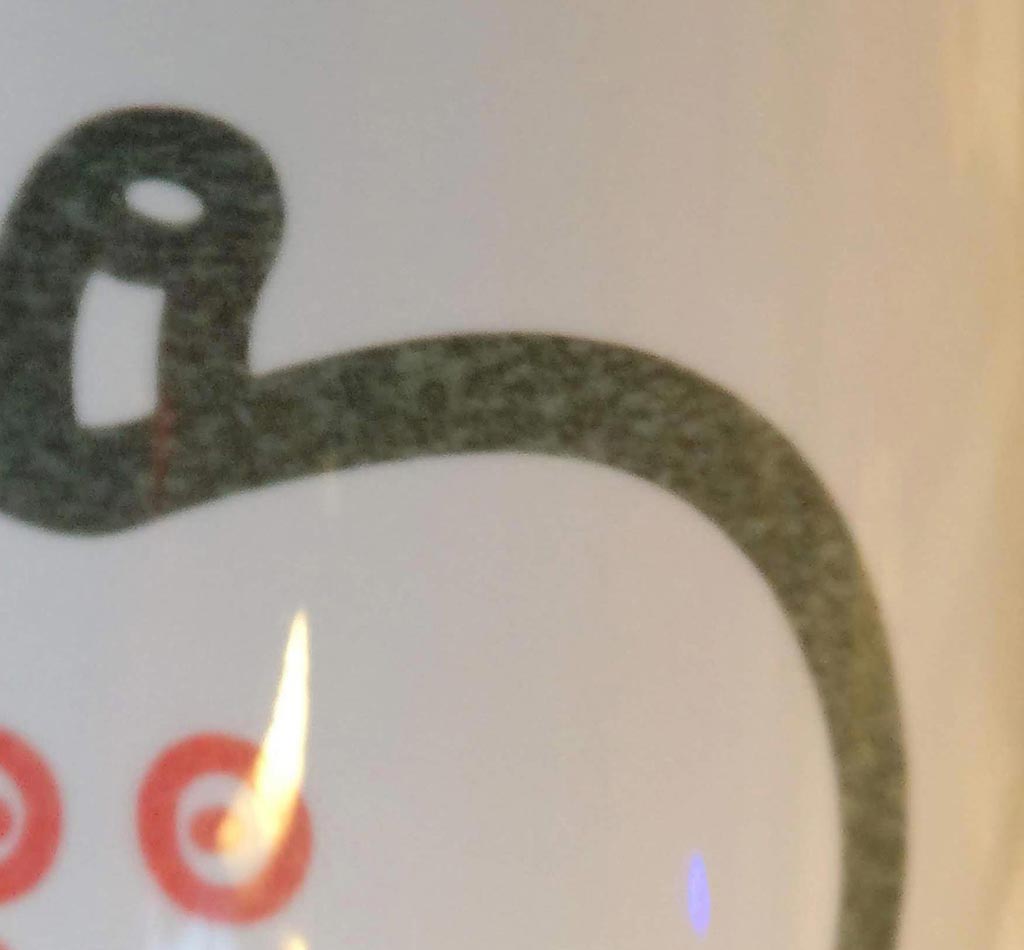

I'm new to sublimation so it's probably something I'm doing wrong but my images are mainly coming out speckled/faded. I'm using a Sawgrass SG400 with Sawgrass inks and papers, LW 11oz and Xpress 10oz mugs and a cheap round halogen oven with a temperature gauge inside. I bought some green mug wraps from Amazon which feel tight when wrapped around a mug. I've tried the oven at 180 degrees for 7, 8 , 9 and 10 minutes as well as 200 degrees for 7, 8, 9 and 10 minutes for one mug. I've also tried heating the mug to take the chill off. I use Photoshop to create the image and then send it to the Sawgrass online designer program to print out.
The photo shows how they mostly come out. Admittedly the image is black (or should be) and I've read there can be problems with black. I've also found that the right hand side is usually much better (near perfect) with the left side being much worse. Sometimes both sides are just as bad. I've reversed the paper on the mug (printed it upside down) and got the same result (better right, bad left) so I don't think it's the image. The image is a png file in RGB format.
Is there something I'm missing or could it be this image? I have printed others which have come out a lot better but also others which have come out similar. The black is 100% black on screen (#000000) and one side often comes out nice and black.

I'm printing on the bright white side of the paper (face down in the printer tray). Yes it does look smooth with no speckles on the paper. Thanks for the help so far.

Hi. The only difference between your setup and mine (apart from you using an SG400, which is virtually identical to my Ricoh SG3110DN anyway) is the use of Sawgrass inks and their proprietary software.
I use CIE inks and paper, together with their ICC profile and print directly from Photoshop. My blacks are always BLACK, believe me!
With regard to your halogen oven, mugs, and wraps, I see no problems there, and your prints should have been fine with the thermometer reading 180 to 200 degrees, and 9 or 10 minutes is about the norm with regard to time.

Update. I've switched my ink and paper over to City Ink Express. Bingo! I've only done a couple of samples so far but everything is looking good. My blacks are really black and solid. No more fading or speckles. :biggrin:
A big thank you to everyone who helped me out on this thread, especially socialgiraffe and webtrekker.
