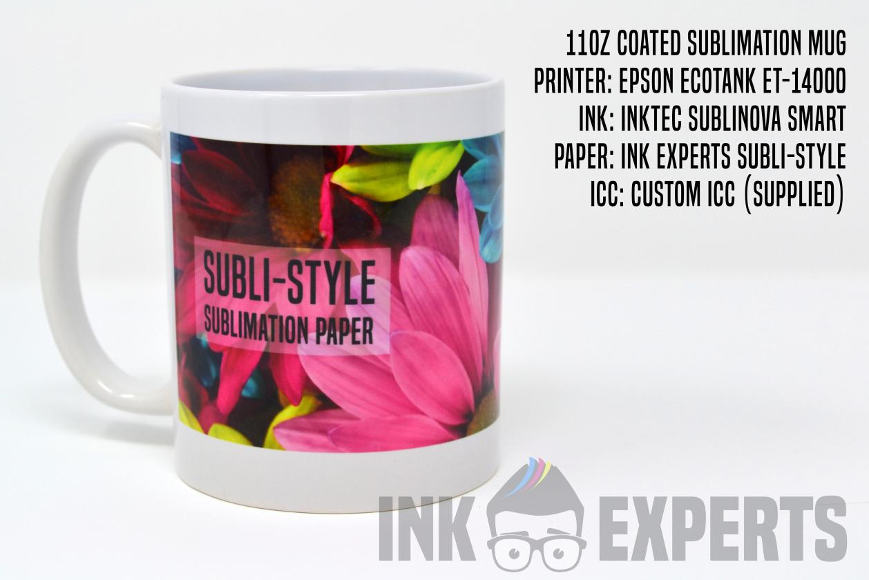

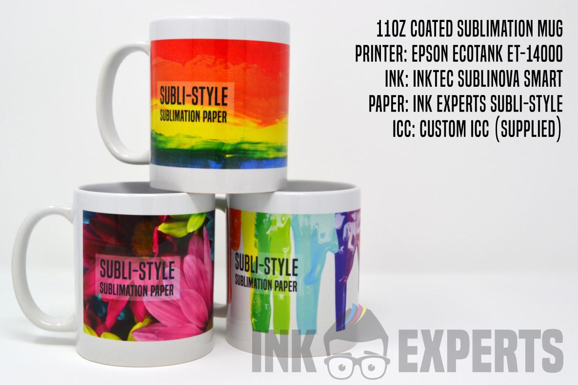

On hard surfaces the picture quality is sharp and vibrant.
Lines are held well and there is a high level of detail in photographs.

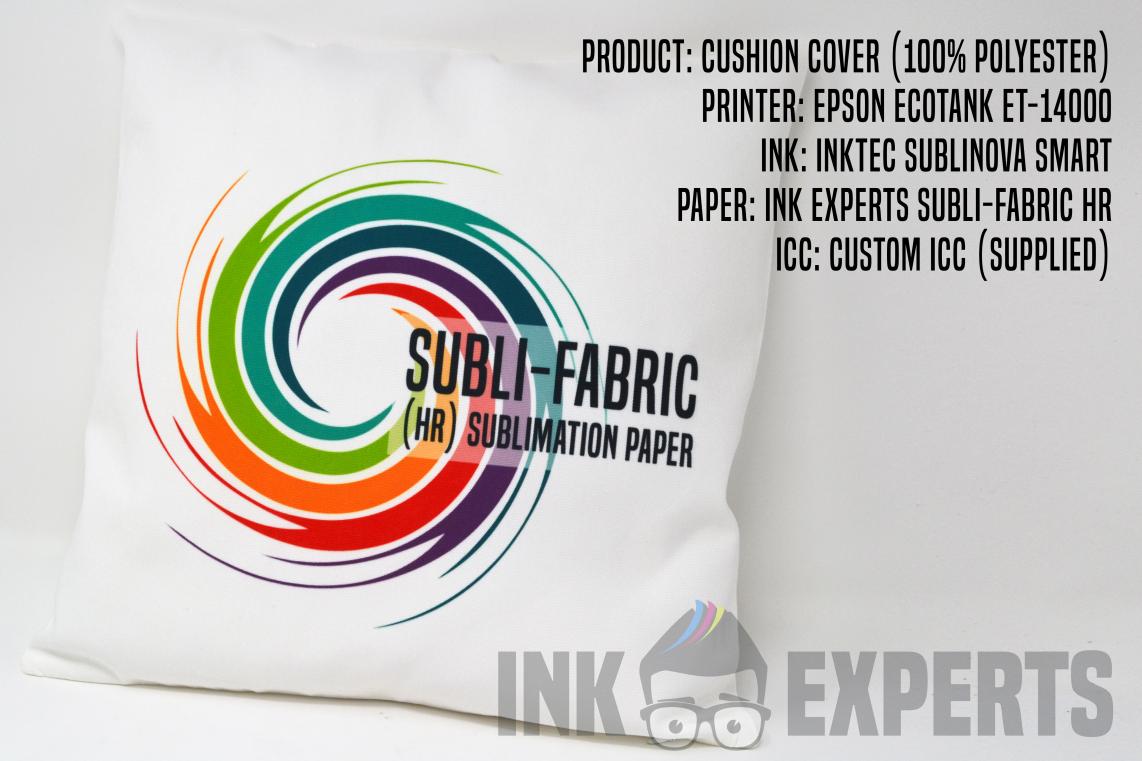

With fabrics we found colours to be bright and vivid.
Again, lines are sharp and detail is high, though some aspects of the image are lost due to the porous nature of fabrics.
