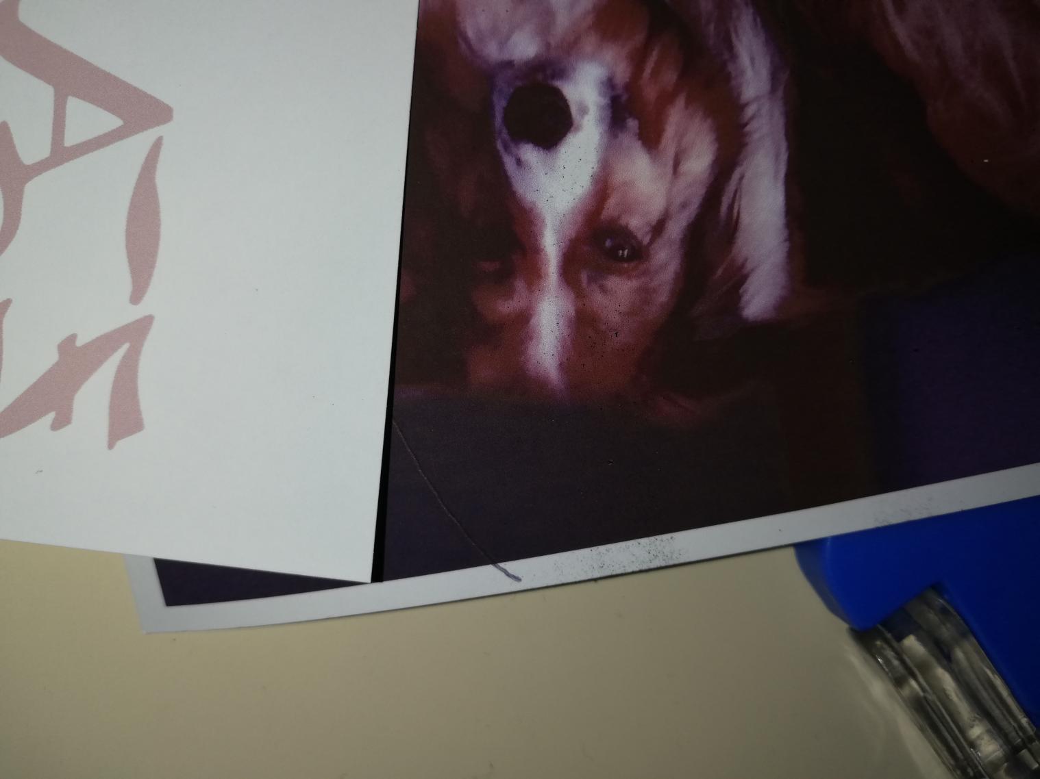

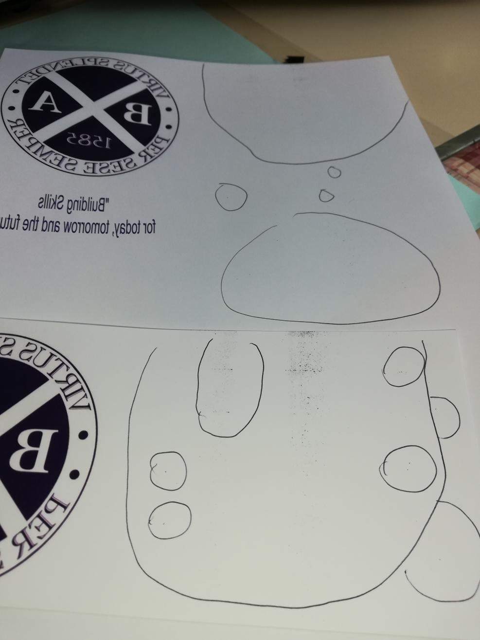

I very recently purchased a bundle off Ebay of a Epson WF-2630 with refillable cartridges and ink. Since i have got this i have had nothing but trouble. First of all when i pressed a mug i noticed i was getting micro dot black ink splatter. On closer inspection i noticed when the paper starts to come through to the print head, the second feed roll in from the left hand side i have a black mark which starts and continues down this line. I got onto the Ebay seller and they have been helpful and thought it might be the black cartridge leaking. They sent me out a replacement along with a pack of paper as i have wasted so many cups trying to clear this.
On installation of the cartridge today nothing has changed, still the same. Unfortunately the company went off yesterday on annual leave for 2 weeks so i am goosed as to what to do next. I have to get going, i have a couple of urgent upcoming things to do. I am sat here with an email ready to send asking for a replacement or refund. I am out of action now for the next 14 days.

From the pictures you sent I would say there is unfortunately a problem with the print head.
The over-spray you are getting looks like the nozzles are slightly perforated, are wider than they should be, or have something blocking the path of ink causing a build up of excess pressure in that row.
Not much can be done about that with regards to repair apart from a new print head, which for the cost you may as well just replace the machine.
Unfortunately this is just a bit of bad luck.
We sell a lot of WF2630 ad haven't seen this problem, but like with any other mass produced product you are bound to get a few come off the line with defects.
