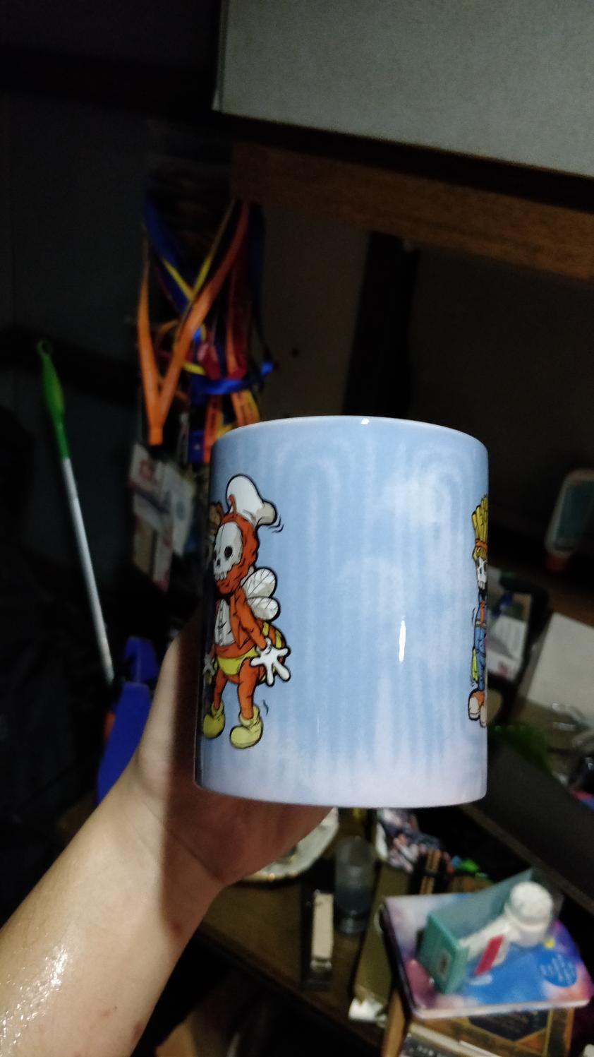

[ATTACH=CONFIG]5907[/ATTACH]
Hi,
I used a mug press and this is my first time doing it. What did I do wrong? There are patterned lines presumably from heated material from the mug press.
Temp: 330
Time: 60 seconds
vB_ID:5907
vB_ID:5907
Quinsfan
Posts: 1213
Joined: 13 Nov 2013, 15:50
Re: Sublimated Mug has lines from heat press
Post by Quinsfan »
We would need more information about the press but yes that looks like the heating element. Have you any photos of the press?
Posts: 12101
Deffo the heating element. What pressure are you using? I assume that's around 165c? 180c for 180 seconds is a good starting point.
