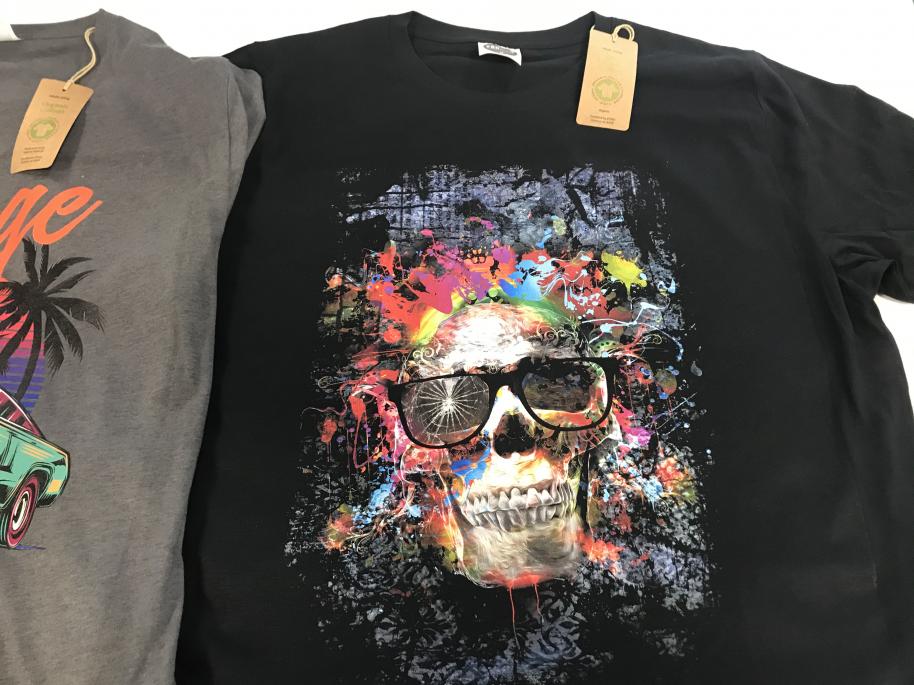

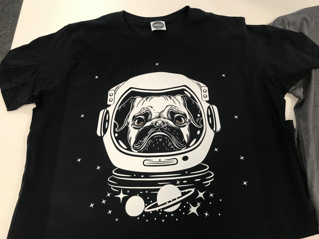

Attached are a few prints that I produced this morning for our display at P&P.

For the prints pictured I used the following equipment:
Schulze pre treatmaker VI
Sefa rotex swing press (curing of the pre treat)
Epson F2100 to print
Sefa T dry Drying cabinet (to cure the ink)
https://www.xpres.co.uk/p-9977-sefa-t-d ... 0-dtg.aspx

The prints pictured range from £1.30 to £1.58 in ink costs
Pre treat works out around 7p per spray I sprayed the shirts twice.
