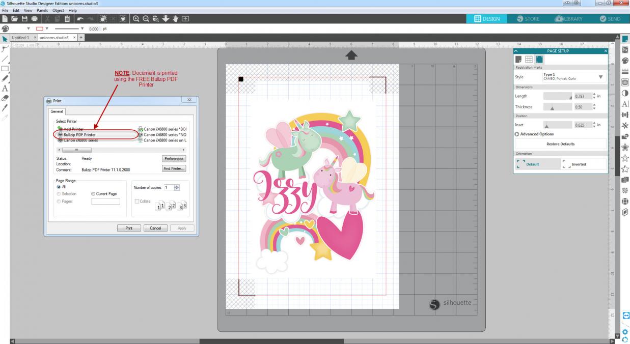

Ok. Thought I'd spend a little time on this.
I have Silhouette Studio Designer Edition (SSDE) that I haven't used in a long time as I never use my Cameo now. However, I can outline the process for saving as a PDF and printing with Photoshop.
1. Make sure your design displays registration marks then PRINT (don't SAVE) to a PDF printer driver. I use the free Bullzip driver. This will create a PDF document instead of a physical printout.

[ATTENTION!] This was a quick lashup to show you the process. In reality, you would have to FLIP the image horizontally in SSDE so you had a mirror image for applying to your garment. IT'S NO GOOD flipping it in Photoshop as this would also flip the reg marks! Take care!
Hope this helps you out. Contrary to popular belief, you CAN produce PDF's from SSDE and most other cutting software using this method.
