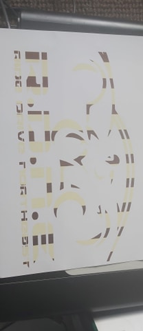

Hi i hope someone will be able to help me with my printer.
I have just got a second hand aficio sg3110dn and when i go to print some think its printing with black and yellow lines up and down.
I have youtubed it and it says i have to clean the heads and says to do this i have to use the menu buttons on the printer but they also dont seam to be working.
hope some one will be able to help me with this.
Thanks Dean [ATTACH=CONFIG]6177[/ATTACH]

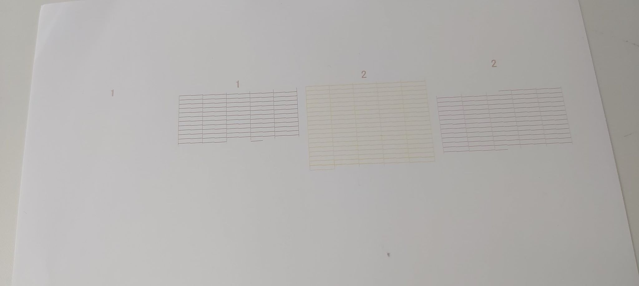

Can you post a picture of an actual nozzle check?

[ATTACH=CONFIG]6183[/ATTACH][ATTACH=CONFIG]6184[/ATTACH]Thats the pics thanks

Re: ricoh aficio sg3110dn
deano1234;143113 wrote:[ATTACH=CONFIG]6183[/ATTACH][ATTACH=CONFIG]6184[/ATTACH]Thats the pics thanks
Wow! That's really bad!
You may have been sold a duff printer.
You're only getting black and yellow because they are the only nozzles working, and even then they aren't great. You need to do some head cleans and print a few heavy images to try and get some ink through, but it doesn't look too good to me.
