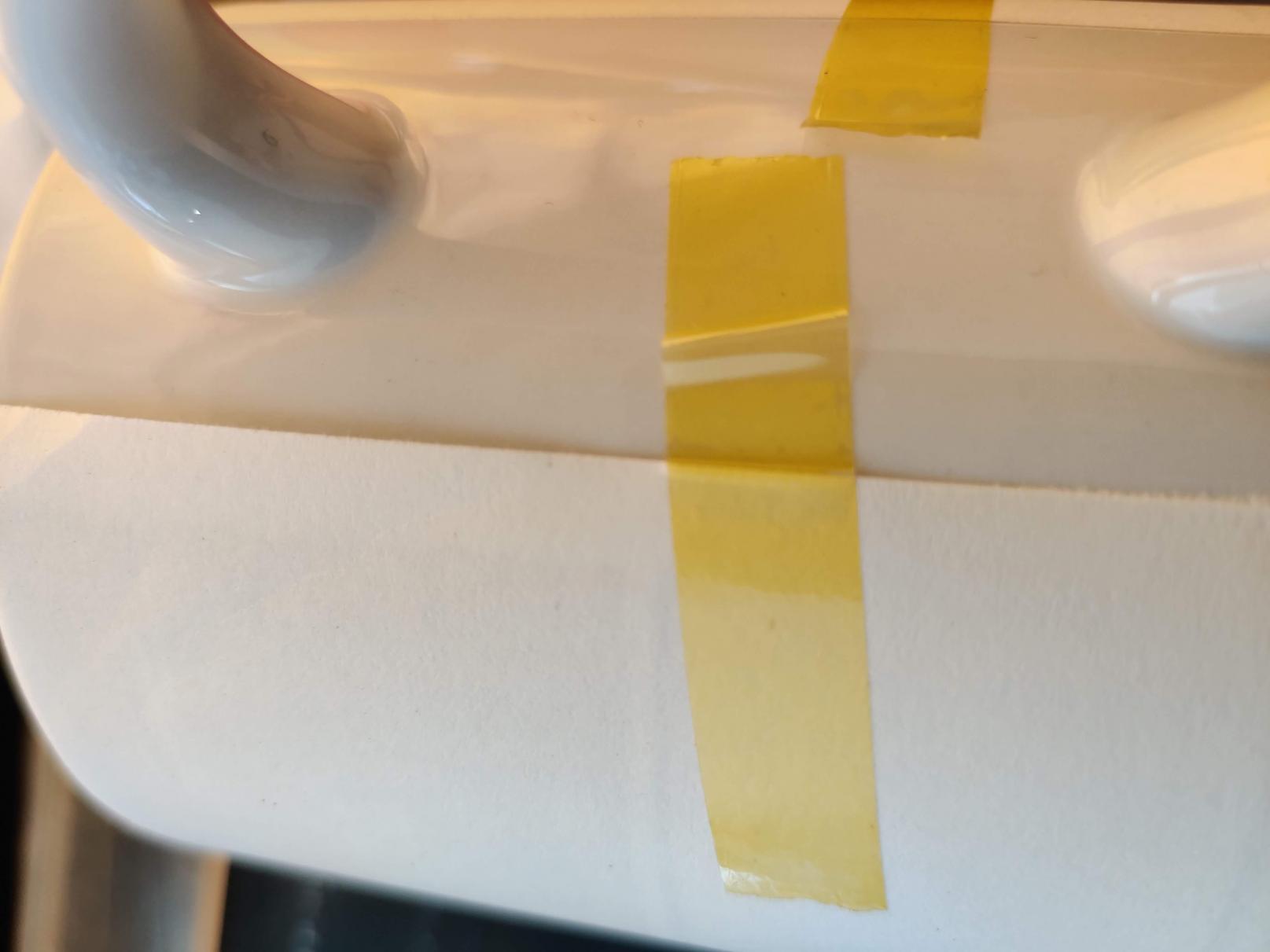

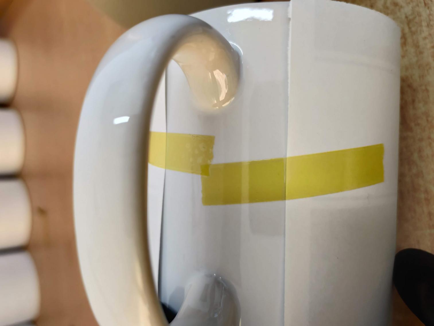

How am tape:
[ATTACH=CONFIG]6207[/ATTACH]

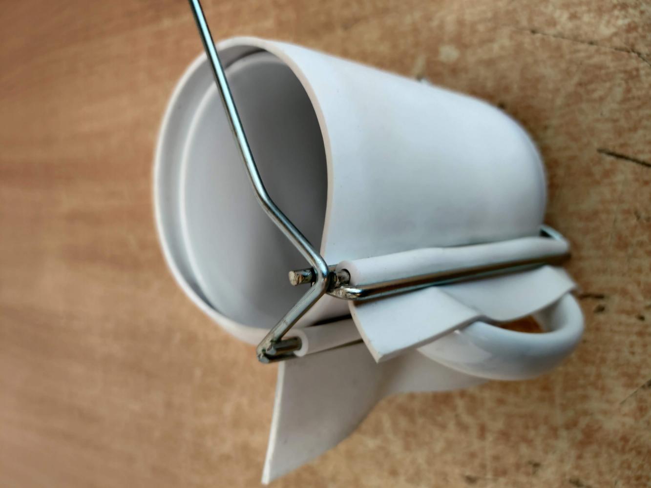

That's my sillicone wrap:
[ATTACH=CONFIG]6208[/ATTACH]

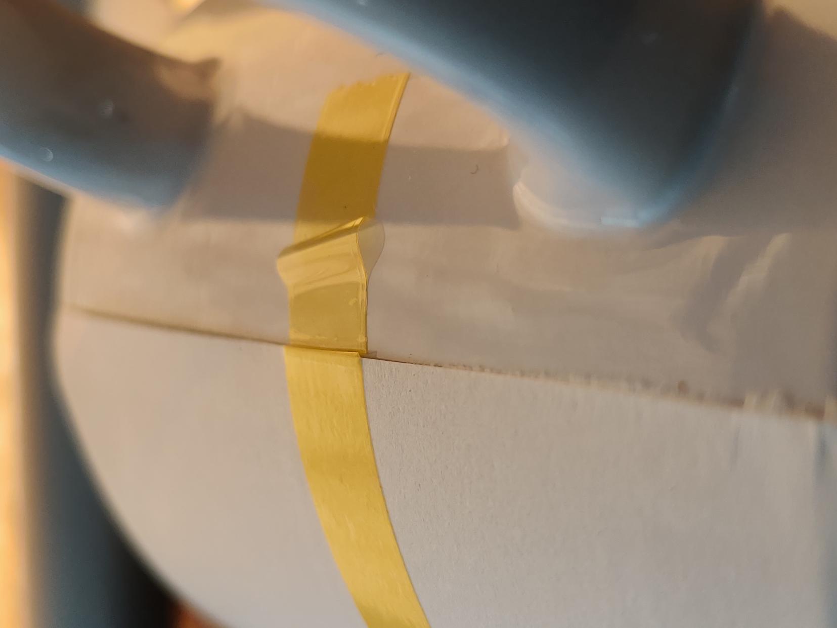

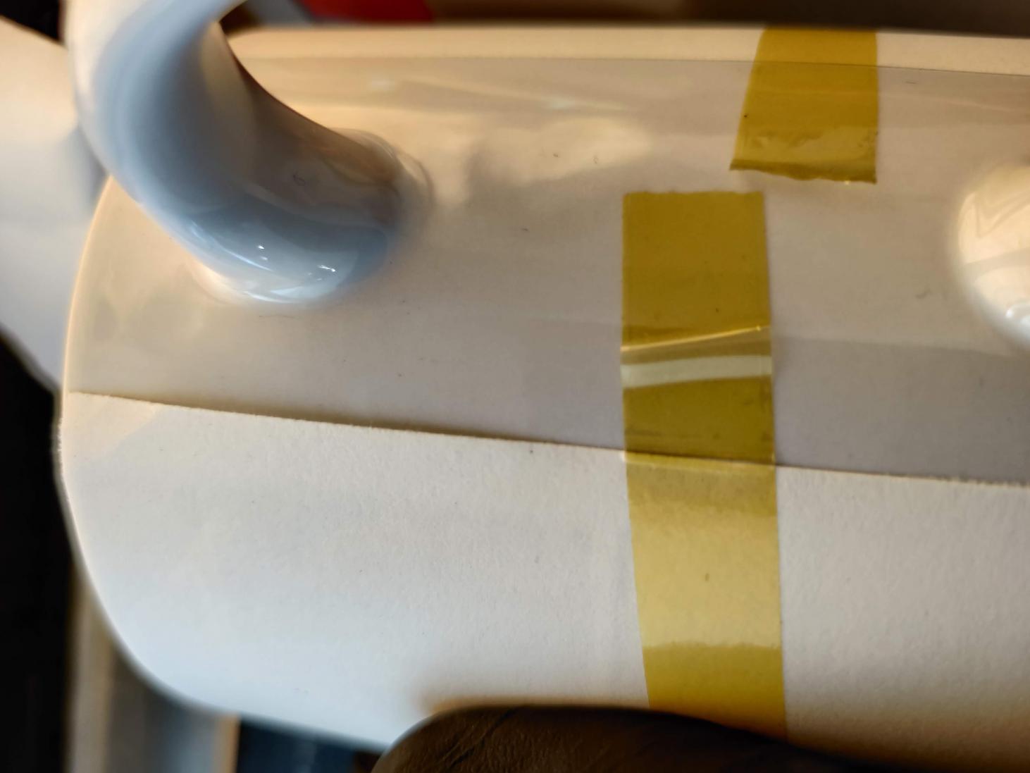

That's failed mug after taken out from oven. Second image shows that it shifts position, tape going under paper (when i stretched by thumb an paper) in related to pic number one.
[ATTACH=CONFIG]6209[/ATTACH][ATTACH=CONFIG]6210[/ATTACH][ATTACH=CONFIG]6211[/ATTACH]

Ive heard someone say once that they put the tape on in the other direction - along the line of the paper, if you see what I mean. I am not sure if they do it to stop the paper moving, but maybe worth a try. (so instead of horizontal like you do now - stick the tape on vertically along the edge of the paper wrap)

I put tape top to bottom on each side paper tight and taped. this way it can’t move.
I would imagine your wraps aren’t tight enough.

I don't think it's the movement because that probably happens when you put the wrap on so before it goes in the oven. Once it's in the oven it probably stays where it is.
Your comment "I've use silicone wraps, and the only one moment when actually all mugs are crisp is when I change silicone for a new ones, till few days after." suggests that even after one use the wrap is getting ink on and causing the blurring on subsequent presses. I use 2 sheets of plain white paper between my printed sheet and silicone to soak up the stray ink from getting on the silicone every time.

Could your silicone wraps either be stretching or slipping slightly out of the metal clamping device and becoming looser?

Thanks for answers, but I found the solution.
It's might be specific for my type of wrap that I didn't saw anywhere else but the way that I wrap them was the problem.
After closing them I need to pull up this part of metal from both sides for a second, one side of wrap rise up and when i release everything goes back as it was. And that's all. Not sure why it does work but now every mug is crisp!
