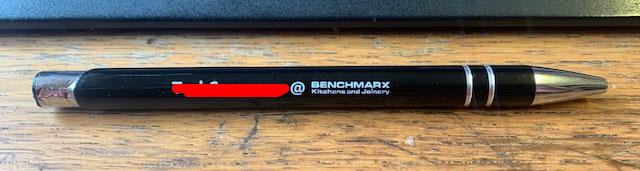

Yes, laser toner transfer. Wanted to see an example of the end result, what the machine can do etc. If you have any pics of this you could pm, would be grateful. However, wanted to see what the actually machine could do before purchase... Thanks
Re: Anyone had problems with Signzworld?
[ATTACH=CONFIG]6254[/ATTACH]
It works best on metal pens (in my opinion). This is an image of a pen that has been floating around my unit (and in use) for over a year now and as you can see, the print is still pretty good.
Its fantastic for personalisation of pens but do not expect to get into bulk as there is no way this machine can compete against companies that are selling printed pens for 9p (including print and pen!).
Its a royal faff to set up the templates and if I were to purchase again I would probably get the "5 at a time" press instead of the 10 because the maximum you can do is possibly 8 at a time (this is because the pen barrels rotate slightly as you are clamping down).
So: Bulk pens NO
But: Pencil sets with names of kids using CPM or RST... pretty good.

Yes, worried about how to set up the templates tbh, how did you even go about it?> Does any info on this come with the machines? I looked at the one on Coralgraph, maybe a better company to buy from so thanks.
The template is set up using trial and error. You can get pretty close just by positioning the pens in their respective slots and using a ruler. But refining to make it perfect requires patience and quite a few pensYes, worried about how to set up the templates tbh, how did you even go about it?> Does any info on this come with the machines? I looked at the one on Coralgraph, maybe a better company to buy from so thanks.
No info about pressing times/temp come with the machine. Again, trial and error will give you that sweet spot.
