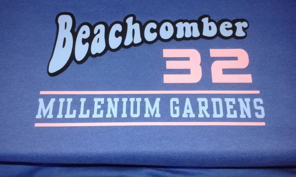

Re: Help advise creating font
If the underside is sticky then it sounds as though you have used SIGN VINYL and not HTV.have attached some photo of the example of the font.
Note when i peel it up the underside is sticky
To achieve the reult you want using HTV you can layer the white on top of the black+outlne, or you can cut the black outline only and position the white inside it.
Personally, to avoid misalignment due to stretching of the fabric, I would use the first method ...
1, Cut the black+outline.
2. Cut the white (no outline).
3. Tack the black onto the fabric by pressing for about 5 seconds.
4. Overlay the white on the black and press or the full recommended time.
Here's a tester I did a while ago. The light-blue 'Beachcomber' text is one layer on top of another black one. After pressing, the hand still feels very soft and flexible and adherence is good. (I used HotFlex vinyl from MDP).
[ATTACH=CONFIG]6577[/ATTACH]
Here are the cut pieces before pressing.
[ATTACH=CONFIG]6578[/ATTACH]
If the underside is sticky then it sounds as if you have used SIGN VINYL and not HTV.have attached some photo of the example of the font.
To achivee the reult you want using HTV you can layer the white on top of the black+outlne, or you can cut the black outline only and position the white inside it.
Here's a tester I did a while ago. The 'Beachcomber' text is one layer on top of another. After pressingthe hand still feels very soft and flexible and adherence is good. (I used HotFlex vinyl from MDP).
