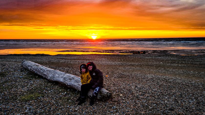

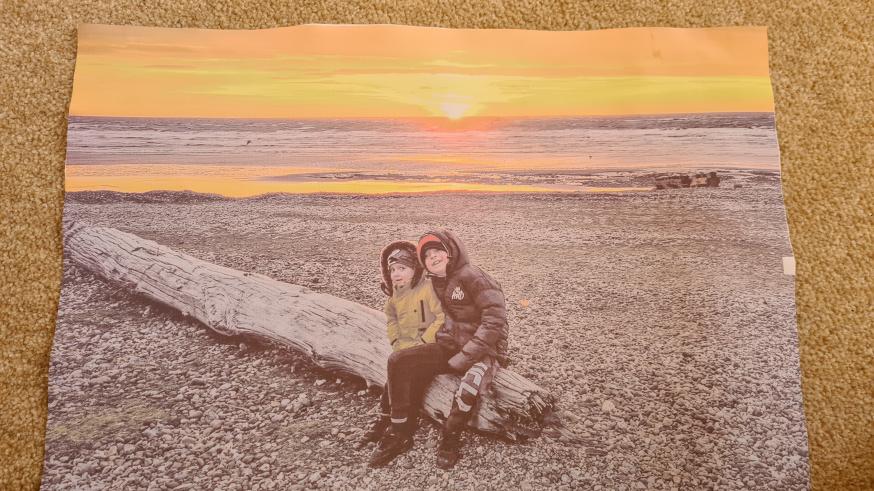

Hey guys, I'm trying out some sublimated canvas prints basically the pic looks amazing on screen and when printed but when i put it on the canvas it looks faded .
I'll try to attach some pics at first I thought maybe printed on the wrong side of the canvas but the smoother side must be the print side, anyone offer any help would be great .
Darren[ATTACH=CONFIG]6580[/ATTACH][ATTACH=CONFIG]6581[/ATTACH]

Re: Sublimating on canvas
What sort of canvas is it? it needs to be 100% Polyester to get the clearest image. I pressed some canvas yesterday and it looks superb but it is 100% Polyester, sounds like yours might not be?
What time and temp?

Justin;147435 wrote:What sort of canvas is it? it needs to be 100% Polyester to get the clearest image. I pressed some canvas yesterday and it looks superb but it is 100% Polyester, sounds like yours might not be?
What time and temp?
180 60 secs and where do you buy your canvas Justin ...Mine should be 100% I think from longforte , thanks for your help

Justin, I solved the problem I done a few test prints and weirdly the smooth side is the back so i was printing on the wrong side.
If it's 100% poly, then both sides should be printable
