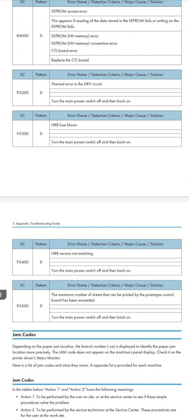

Hi Guys. Has anyone ever come across this error. It just won't go away. I have tried turning the printer on and off and it disappears for a bit and all looks good and then it reappears with the red light on. Please help. Thanks. Jin
Re: Richoh SG3110dn error code: (SC92000)
Hi. There's no such error code in the service manual. Have you typed it in correctly?
I can only find 4 codes beginning with 9 ...
[ATTACH=CONFIG]6936[/ATTACH]
vB_ID:6936
vB_ID:6936
Jin
Posts: 9
Joined: 12 Nov 2014, 10:03
Post by Jin »
Ah - yes it typed it in wrong. It should be SC93200. However I have just found the answer in case anyone else has it from this link https://care.sawgrassink.com/hc/en-us/a ... Code-Guide.
  • [CENTER]Error 93200If you have received this error, your printer might not have proper ventilation. [/CENTER]
    To resolve this error, follow the steps below:
  • First, make sure there is enough space surrounding the printer so that it can have proper ventilation. Just like us, our printers need to be able to breathe!
  • Next, power the printer off and leave the printer off for at least an hour.
  • Finally, you want to check your cooling fan to make sure that it is working properly.
  • To find the cooling fan, look on the left side of the printer next to the USB and Ethernet connection ports.
