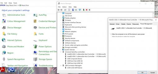

I've been at a friends unit today running some vinyl cuts through. Her BN-20 is incredibly slow at cutting. I am aware these machines are very slow printing but I thought cut only would be much quicker. It seems to stutter every few seconds. I'm almost thinking it's like there's interference on the netwrok that is casuing it to pause.

I had a similar issue with my printers cutting out every few seconds. Turns out it was a power management issue with the computer turning off the USB to save power.[ATTACH=CONFIG]6983[/ATTACH]
