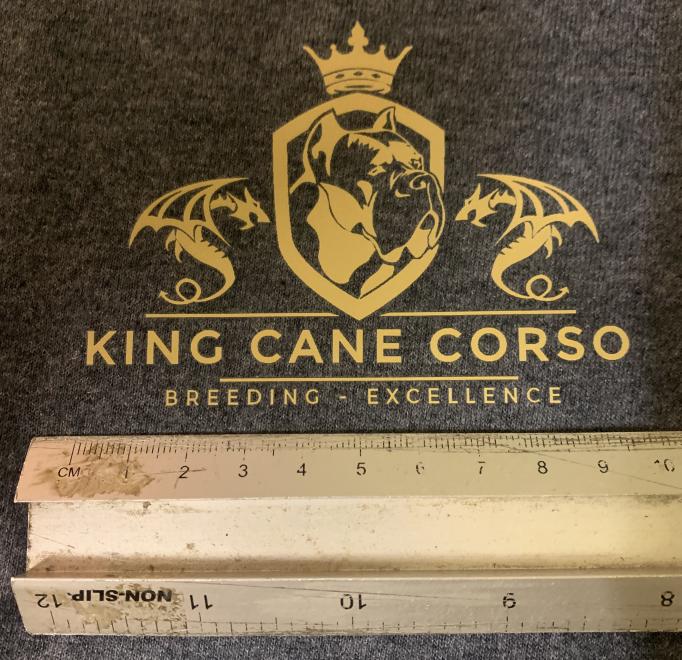

The first transfers I made were for a “friend of a friend” who breeds Cane Corso’s. I had previously printed his garments using my Versacam Print ‘n’ Cut. The job took well over two days to complete due to the complex weeding. I also had to simplify the FLB Logo as it was simply not possible to get the detail required…. Not anymore! The DTF transfers are bright, sharp and crisp. Having been in this business for more years than I would like to admit it takes a lot to blow me away, the ease of creating the transfers and the finished result really did give me the “wow” moment.

I am sure we have all seen these sort of systems before promising everything but always coming up short. I have had Fusion DTF printed garments on test with 25 different people for a little over 3 weeks now. Some have been told “30 degree wash, do not tumble dry etc.” and others have been told nothing. So far not one person has had any issues with no complaints and no returns. If I wanted to be overly cautious then I would recommend either some washing instruction stickers or create your own neck labels on a tag less t-shirt, only you can decide on that as you know your customers.
