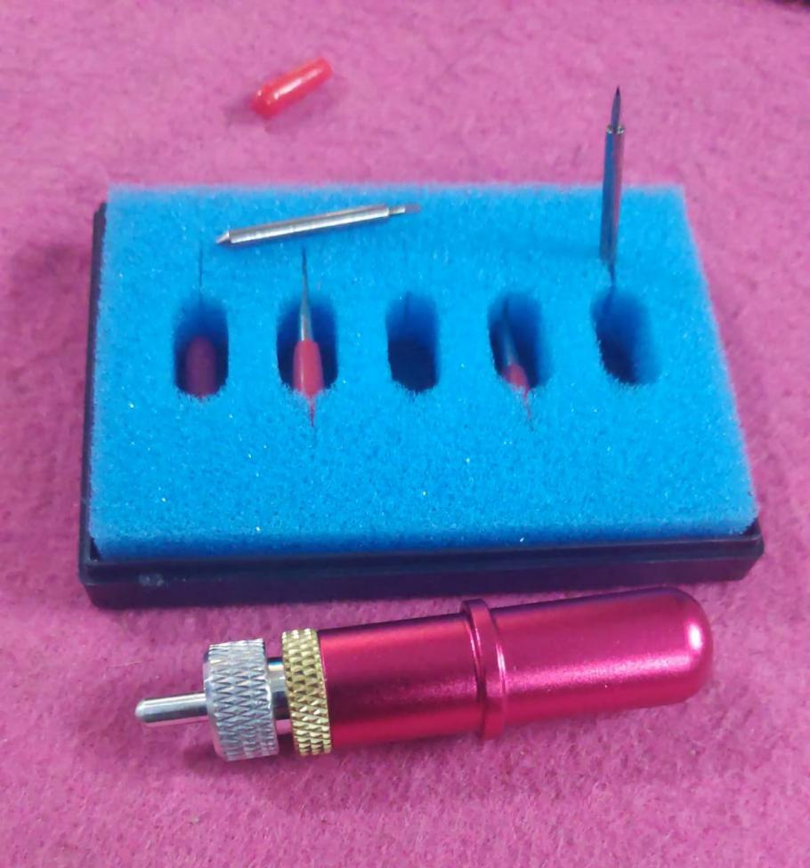

Trying to find a new holder and blade for a machine, suppliers want £60 to ship from from overseas. It's for a Skycut machine.
I'm pretty sure this is a standard holder used across many machines, Roland, GCC, Siser for example. Comparable costs on eBay are £12 for 15 blades and 1 holder!
If anyone uses exact same please let me know. TIA.

Re: Can anyone idenfity this knife holder please? Vinyl Cutter
I think most of the popular blades are 0.94mm shank diameter. Have you an old blade you can measure?

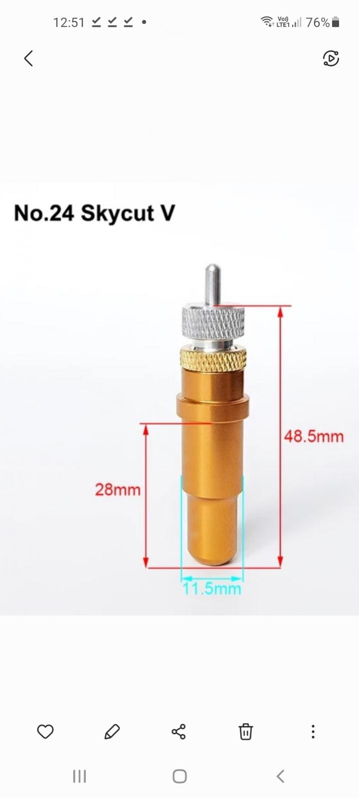

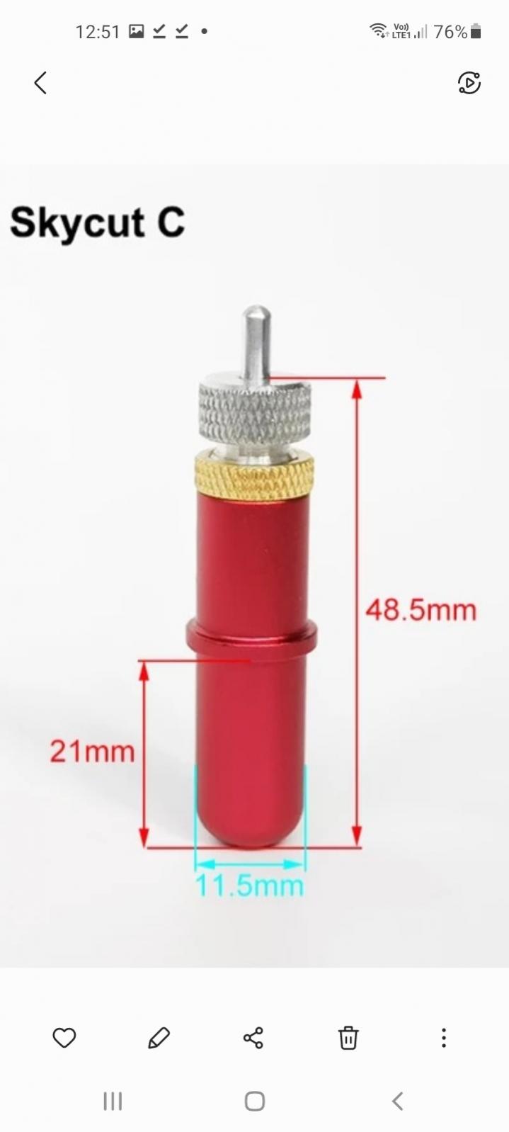

Do you know the machine model number Justin? Here are some blade holder sizes for a couple of models ...
Yes, it's the Skycut A3 Max 2, looks like a C Series...yes, as per your first image.

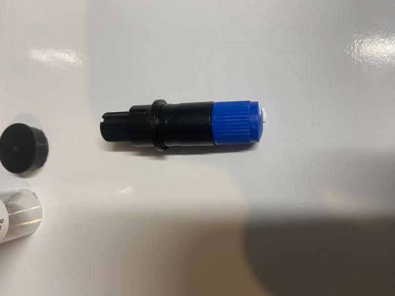

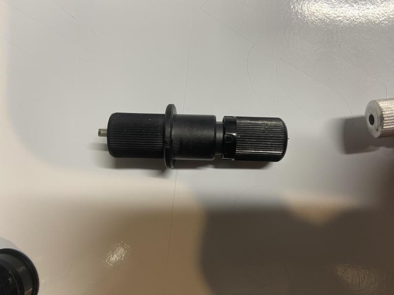

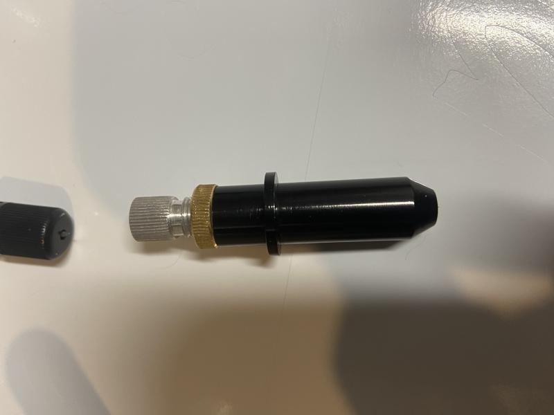

I could send you mine if you send it back when your finished if you are just testing it out?
I have a holder for a Roland, graphtec and a us cutter machine if any of those are the right size?
I have smart knives in all My machines so it wouldn’t be an issue.
Would you mind sending me a quick photo of the holders?
Added on the above post for you fella.
blue tip is graphtec
all black is the Roland
black and silver top is the us cutter.
