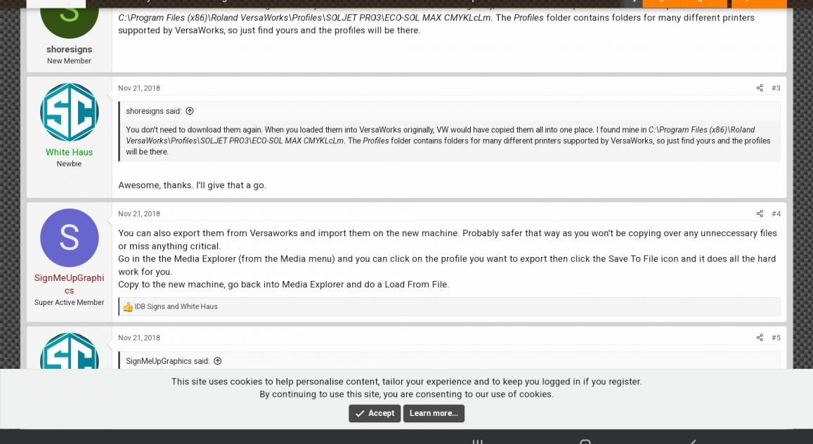

Do either of these answers help?
- vB_ID:7202
- Screenshot_20230616-071126_Chrome.jpg (96.36 KiB) Viewed 3949 times

Re: Help VW queue settings
Tried these but sadly it’s not saving the print queue settings.AGS;152660 wrote:Do either of these answers help?
