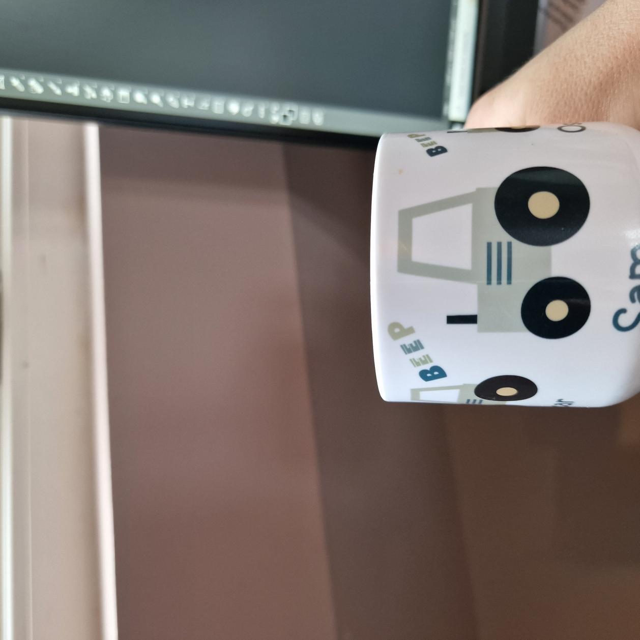

I am new to sublimation but have a technical background so not a complete novice! I have purchased the ET-18100 via ink express and have the ICC profile installed. I've been testing my mug press and I'm happy with the majority of colours but blue is pressing green every single time.
Does anyone know what the issue might be? Attached are some example images.
Thanks in advance.
[ATTACH=CONFIG]7215[/ATTACH][ATTACH=CONFIG]7216[/ATTACH][ATTACH=CONFIG]7217[/ATTACH][ATTACH=CONFIG]7218[/ATTACH]

I'm using the inktec sublinova inks. I've done a nozzle check and all colours seem to be correct and no issues on the print out.

As far as i'm aware - colour management in the printer settings is switched off and using the app managing the print out with the icc profile selected. Paper as Epson Matt and print quality high. I've tried perceptual, relative and all result in the same for blues turning green. I've tried two different presses so it doesn't appear to be a temperature/time issue. I've tried different profiles in Adobe - Adobe 1998 and SRGB to see if it made a difference but hasn't. Also tried with own created images rather than the Etsy purchased ones with the same colour range and the same result happens.
I had noticed over the weekend that Ink Experts now have the 6 Sublinova inks with icc profile listed for the ET-18100 so i've ordered that and paper from them so will see if their profile works better.
