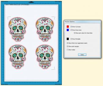

Ok, assuming you already have the print from your BN-20 complete with Regmarks then it should just be a case of placing your print on the cutting mat and going into the Print & Cut dialogue again and clicking 'Next' (or whatever appears for your cutter) to locate the marks and start cutting the job.
[ATTACH=CONFIG]7237[/ATTACH]
[ATTACH=CONFIG]7236[/ATTACH]
(Sorry for the poor quality pics, the forum uploader seems to resize them to minimum size).
My Silver Bullet machine uses a red dot laser regmark locator which means I must locate each mark manually. I find this much better and more stable than the automatic ARM systems.

Yep I do this but instead of scanning for the reg marks it just starts cutting tiny text.webtrekker;153076 wrote:Ok, assuming you already have the print from your BN-20 complete with Regmarks then it should just be a case of placing your print on the cutting mat and going into the Print & Cut dialogue again and clicking 'Next' (or whatever appears for your cutter) to locate the marks and start cutting the job.
there must be a setting causing this somewhere.
maybe the hpgl settings or something?
as in a previous post it’s also feeding backwards the screen shows the feed arrow on the left so it should start at the left point but instead it starts at the right
