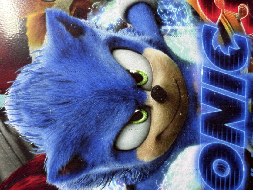

I found this great forum and I come to you because I´m having some issues sublimating metal boxes in the vacuum machine.
The problem is that some little spots, stains and kind of strands appear when sublimating. As you can see in the images it also happens that colours are not vibrant, blacks are not deep and there is a kind of grain/noise mainly in the darker sides.

Basically pre problems are:
- White Stains, dots, threads on sublimation (They're not in the print)
- No deep colours. Everything feels like a bit washed.
- Grain. Particularly in darker places.

Re: Issues sublimation metal box. 3D Vacuum machine + Epson F100/170 + Silver 3D film
this is old post but that is from print pin wheel. they are tiny wheels with pin like points that feed the paper through they have ink on them and so it goes onto the paper and when heatpress turns dark
