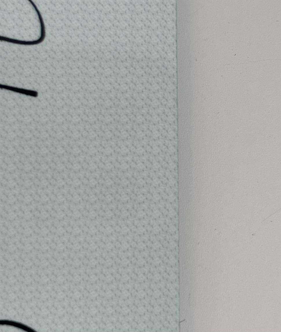

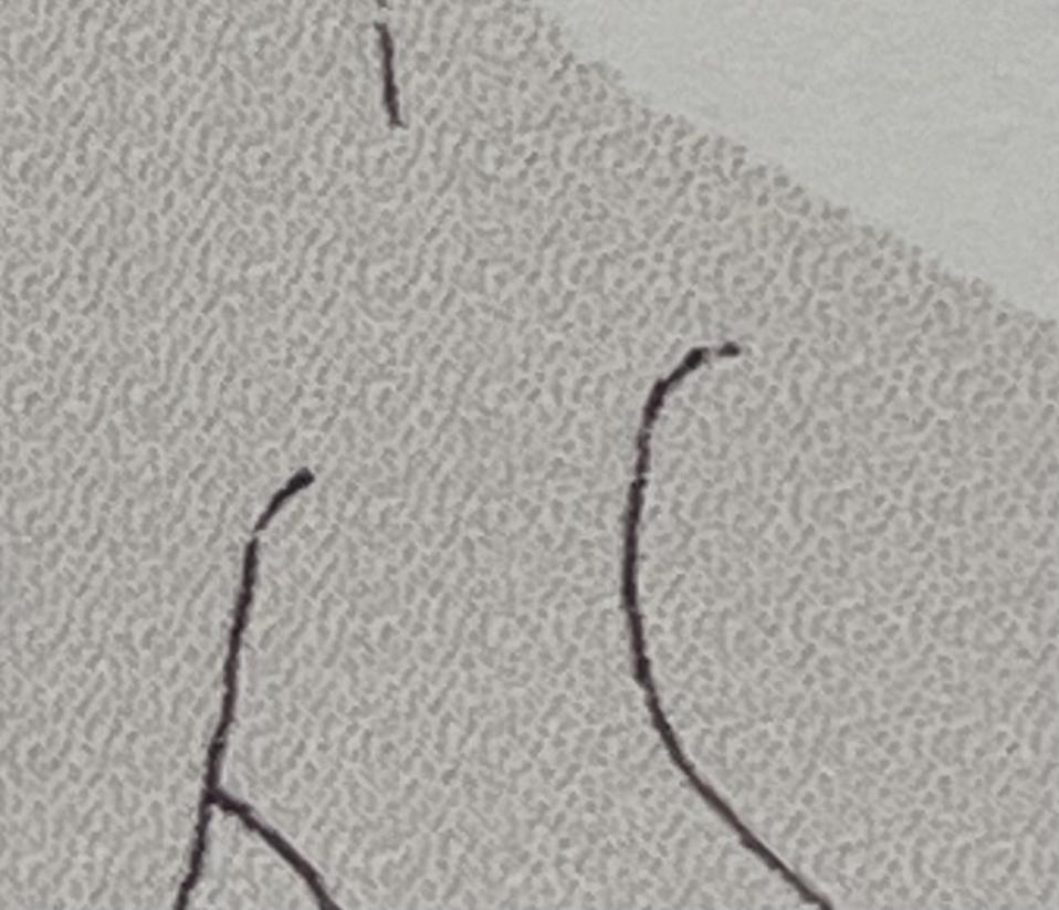

Hi everyone,
I’ve been in the sublimation business for 15 years and can usually fix most printer issues but this one has me stumped. Since the new Sawgrass Print Utility came out, my prints have gone from crystal clear to grainy. Solid colors now appear dotty and textured rather than smooth, fine text is hit or miss, and the colours are completely off.
I’ve already done all the usual checks—nozzle checks, head flushes, different paper/settings—but nothing seems to improve the print quality. Has anyone else experienced this with the new software? If so, have you did a fix? I can add pictures if it helps. Would really appreciate any advice! Thanks in advance.

[ATTACH=CONFIG]7437[/ATTACH][ATTACH=CONFIG]7438[/ATTACH]Adding a picture to help with the issue. Thanks in advance
- vB_ID:7438
- IMG_3269.jpg (82.24 KiB) Viewed 2920 times
- vB_ID:7437
- IMG_3270.jpg (87.66 KiB) Viewed 2920 times

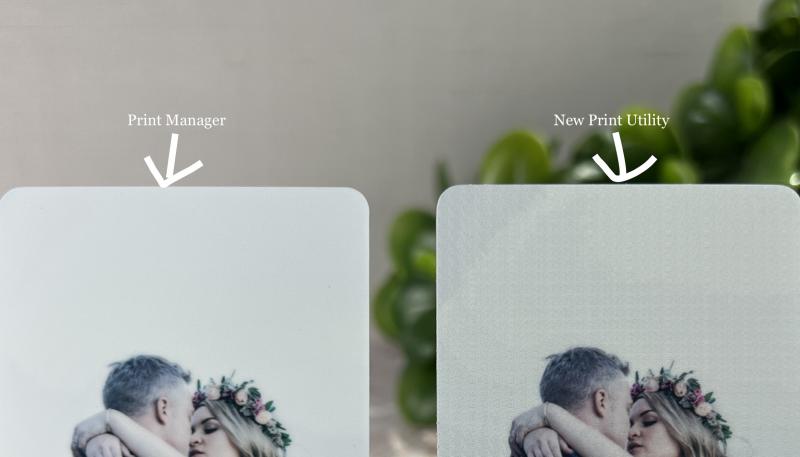

Re: Major Print Quality Issues After Sawgrass Print Utility Update
[ATTACH=CONFIG]7440[/ATTACH]
The photo on the left was printed with my Sawgrass SG500 with the old Print Manager. The one on the right with the new Print Utility. I've tried several settings, can't get the images to come out clean.
Trying to find the correct ICC so I can print directly from Photoshop to my printer and bypass Print Utility. I purchased a copy online but it isn't working clearly. Will continue to email Sawgrass and work with ChatGTP for a work-around.
