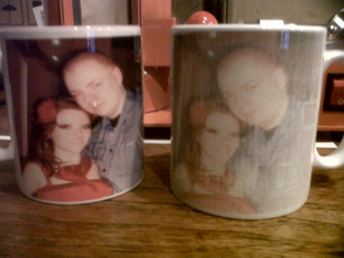

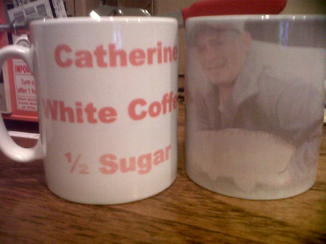

hi all......im having a lot of problems getting my printright on my cups....i have a tigger mug press....i can print 3 designs on a sheet all the same design...when i put my 1st mug in it transfers great...but the 2nd mug is very faint.I gave the machine time to heat up again before i put the 2nd mug in??.......i just cant understand whats going on i seam to be wasting a lot of mugs...i have come to the conclusion it cant be the paper or ink could it be the mugs? or the heat press.....i am very confussed and any help is greatful

yes thats the one its a orange one........as you can see from the pics one of then is good and the other is very faded ......its the same on the text pics as well ........its confusing me
Re: faded text and image
it looks like your heat press is not hot enough! how do you know if this press reach the wanted temp??? have you got it displayed on the screen?
