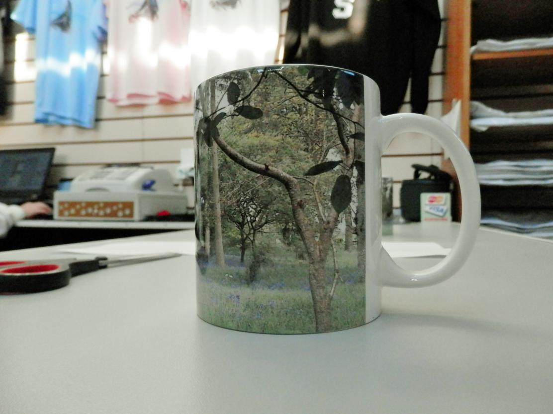

The standard pre-cut wraps are great for everyday use but Ricohs don't print borderless, I wanted full depth prints the other day so printed on a full A4 then cut it out around 10mm deeper.
Using a mug press meant that I needed to heat the bottom first so just dropped my swingaway on it and left it for about 5 minutes to heat up. Pressed as normal in my press.
BMS mugs and BMS press.
