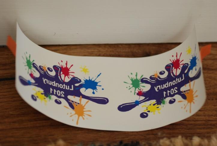

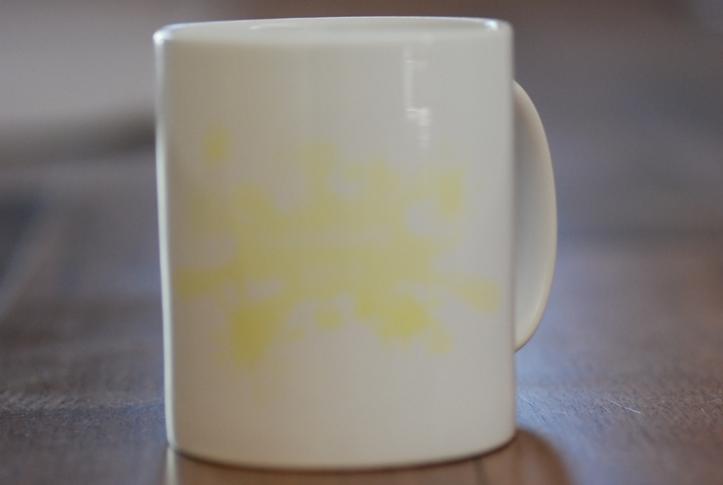

Hi all,
My first post so I'm hoping someone can help...

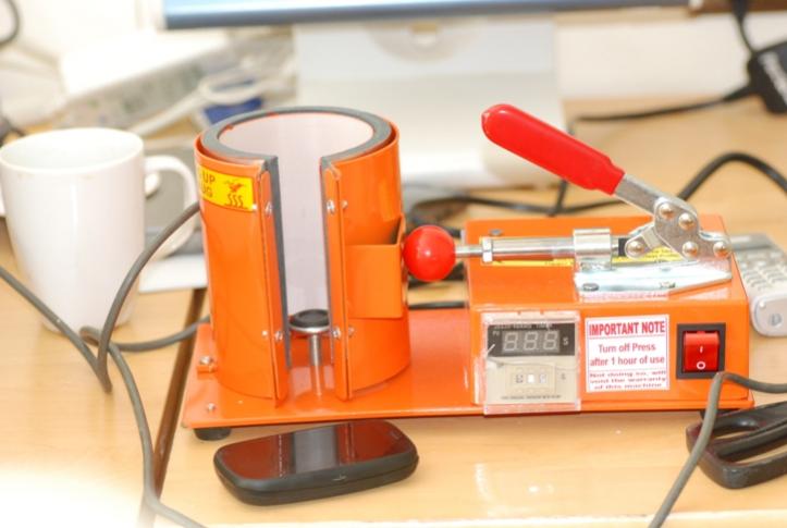

I have a new Ricoh GX e3300n printer, some sublimation paper, some sublimation mugs from coralgraph and a mug press. It is a cheap mug press but as I'm not doing this to make money I'm hoping that it will do for me.
Here is the what I do.
I print the graphic on the paper - it always looks fine with good sharp colours (have tried both sides in case I was using the wrong side)
I then heat up the press according to instructions
I tape the graphic to the mug (ink side nearest mug, blank side facing out)
Place mug in press and leave (I have tried different times from 2 minutes to 7 minutes)
When I remove the paper I have a very, very hot mug with a faint yellow image on it and no other colours.
I am using the ink that came packaged with the printer and use the driver from the disc supplied.
My question is does anyone know what I am doing wrong? Why would the different colours on the image all appear yellow on the mug? If I were to leave the mug in longer would the other colours come true?
I have attached a few pictures for you to see.

are you using sublimation ink?
if your using sub paper and the image looks clear and sharp on the paper it shouldn't
when sub ink prints on the paper it's really dull

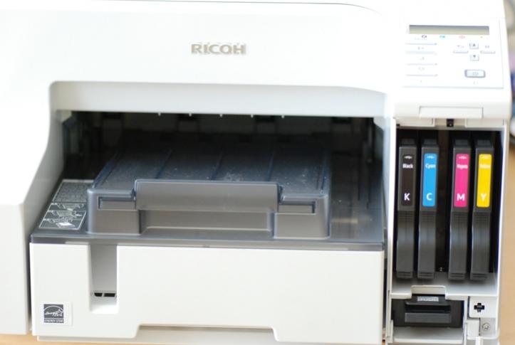

Re: Image appears yellow on mug..! Why?
from looking at your printer i'd say they are the standard inks that came with it and not sub inks
although i don't have a Ricoh so can't advice what they should look like though so may be wrong
where did you get it from? and did they say it was sub ink?
I've phoned the supplier and they confirmed the printer came with gel ink... not sublimation ink. They also said that Ricoh does not advise using it for dye sublimation... I've looked on this forum and many people seem to be using it for that so I'll bite the bullet and order some 'proper' sublimation ink.
Thanks... I'm so happy that my cheap mug press isn't the problem as I like the colour orange -
Any advice on best place to get the ink from?
