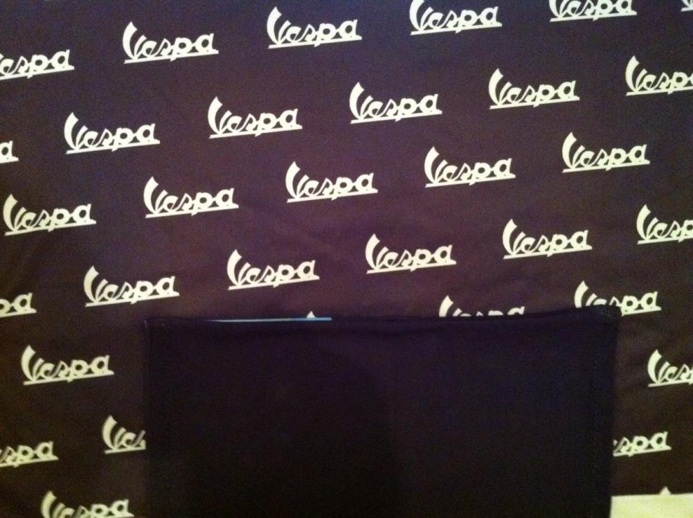

A photo of the problem print would be good.

Here is a photo. the black at the bottom is the colour I should be getting or there abouts, the top is what am getting now
[ATTACH=CONFIG]561[/ATTACH]
I cant make the picture any bigger
