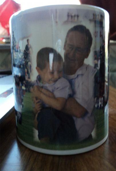

Please, see the sample of my "best" mug so far.
[ATTACH=CONFIG]610[/ATTACH]

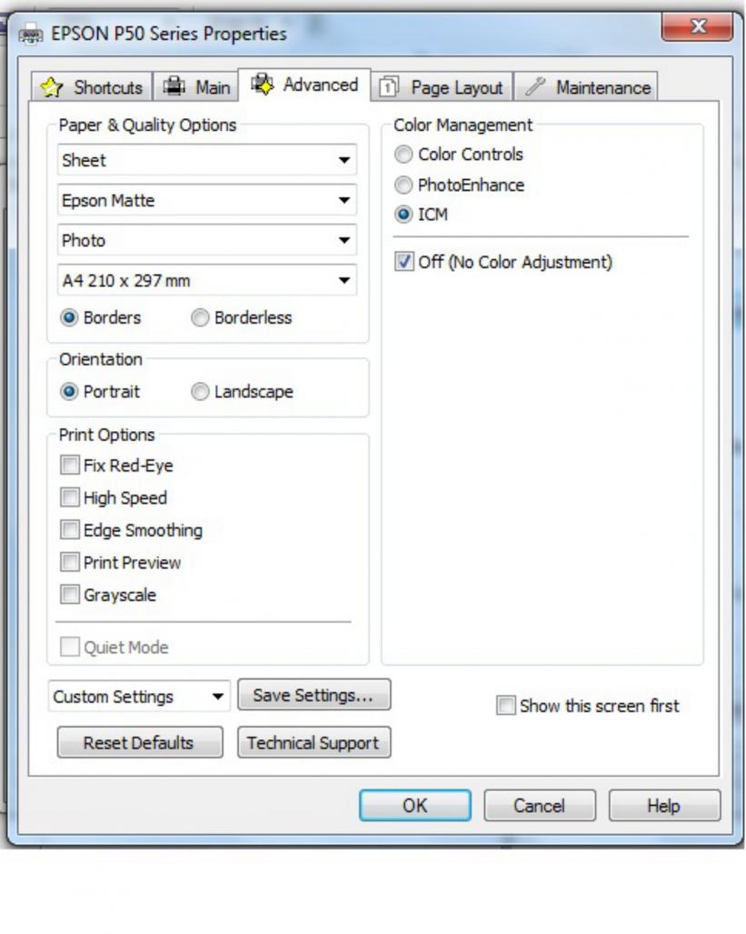

Printing parametres
Corel Draw Default color Management settings : RGB color profile is set on SP T50 P50 T60 Standard
After pressing File>Print>Properties I choose Photo print on Epson Matte Paper. In advance tab I choose Color Management ICM and off (no color adjustment). Here is the photo

People have a grey skin, image is not bright.

Hi anna. You need to use icc profile. You need it to tell your printer how to mix the colours to get great results. Standard printer profile is no good. Also in printer driver i would think edge smoothing and high speed. Also check if you print on correct side of your oaper. Ps. Link to your mug does not work.

First thing we need to establish is what paper you're using and where it came from. Next, we need to know what sort of ink you have. If this ink (as I suspect) is third party and not supported by Sawgrass, we cannot discuss this here.
The P50 is a fantastic printer for sublimation but as Paul has mentioned, you need the correct profile for the inks.papers you're using.

[ATTACH=CONFIG]611[/ATTACH]

Paul will do you a profile for £25 - have a look in the offered/requested section - there is a thread somewhere and in the gallery you can see someone who posted a mug before and after Paul did the profile. The difference speaks volumes...

Can you post a photo of your mug press? You're obviously using sublimation paper as the image is there and the colours don't look toooo far off, it just looks washed out which could be the press/heat settings.

I'm just wondering if giving the D88 profile a go might improve the colour a bit. It just may brighten things up enough & doesn't cost anything to try.

worth to have a go with ready made one. can we see the photo before it when on the mug?? so w eknow how far is off...

I've sent a profile to Anna so that she can at least get that bit working right, I'm still thinking it's more to do with the press though.
