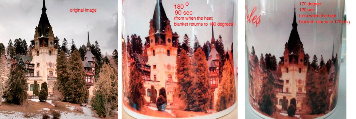

Hi bms,bms;39267 wrote:Can you confirm you have tried 170 degrees for 2 minutes (2 minutes from when the heat blanket returns to 170 degrees)?
I just tried with your suggestions. Evan more bad results.
I will atachhed the original photo, my settings, and your sugesttion to see the results.
The results are similar on different printers and heat presses.
Software settings are exactly acording to sawgrass site.
Thank you!

Re: Ricoh GX 3300N red colour problem
The colours are getting better on the lower temperature. But the blurred image on the far right might suggest it is still being overcooked. I would be inclined to drop the temp/time further. It might be worth a couple of further tests (smaller images to save wasting lots of mugs). Put a small print on one side of a mug. Try temp 170 degrees, 90 seconds; Temp 160, 60 seconds.edmond1815;39289 wrote:Hi bms,
Thank you!
Is there a happy medium between these settings? What are the results like?
