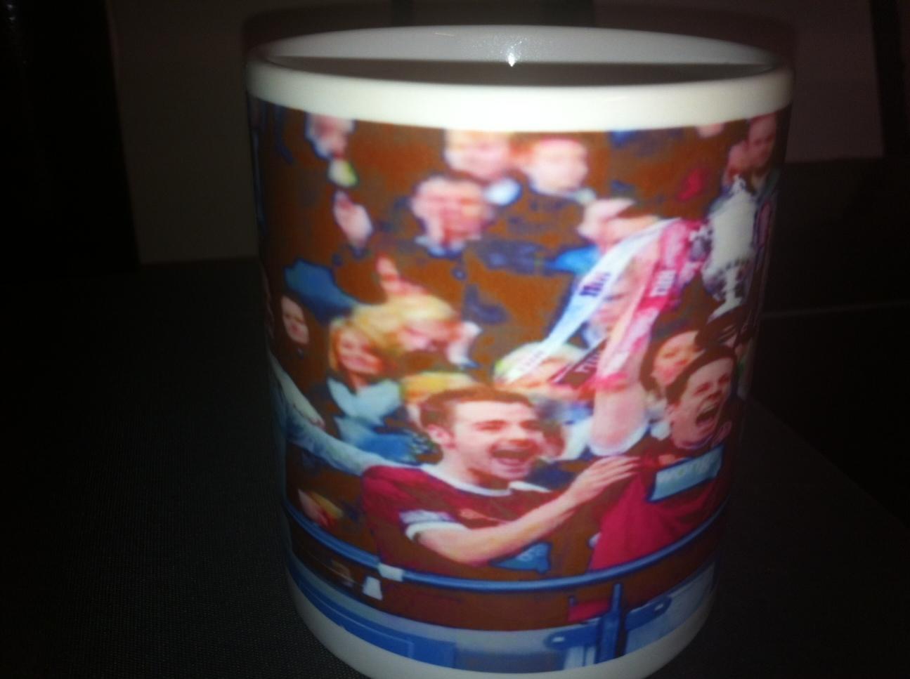

Hi all just got a ricoh 3300 from bms thanks great price with me being a member here :-)
ok all set up but my black is coming out brown on mugs ?????

maybe to high temperature??

[ATTACH=CONFIG]1034[/ATTACH]i will give that a go phone covers come out ok just the mugs

'As a guide for Ricoh printers we would recommend an idle temp of 110 degrees, an operating temp of 170 degrees and a time of 140 seconds, but we do have some customers that report excellent colours by setting a time of only 80 seconds with the Ricoh printer using our mug presses'
This is the info off BMS own website for ceramic mug printing so wonder if this might be of some assistance?

I had some problems with my first few outputs and on advice from BMS I now set my heat press at 170 for 50 seconds and prewarm the mug.....works every time now.

I too have the press set at 170 but time is 70 seconds - not had any problems with these settings either.

that looks like a profile problem to me

derekwolves;46435 wrote:[ATTACH=CONFIG]1034[/ATTACH]i will give that a go phone covers come out ok just the mugs
Certainly looks like over cooking - lower your temp and lower your time. What time/ temp combination are you using?

yes yes yes thanks all for the advice :smile:
worked by just adjusting the time
