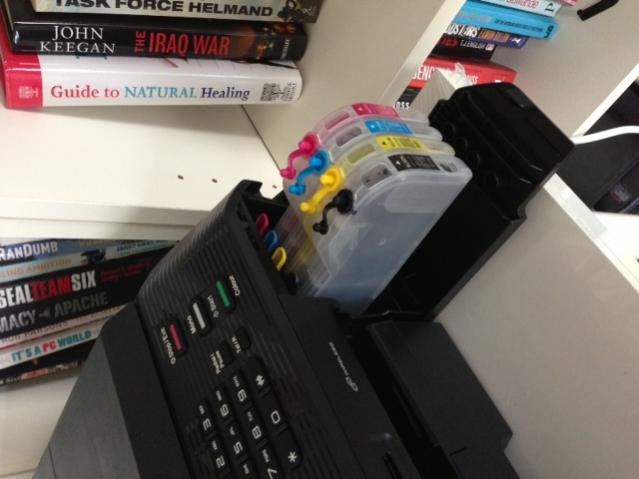

can you post picture of your refillable carts?? did you removed rubber chop out??
Re: Brother printer unusable print quality
[ATTACH=CONFIG]1213[/ATTACH]

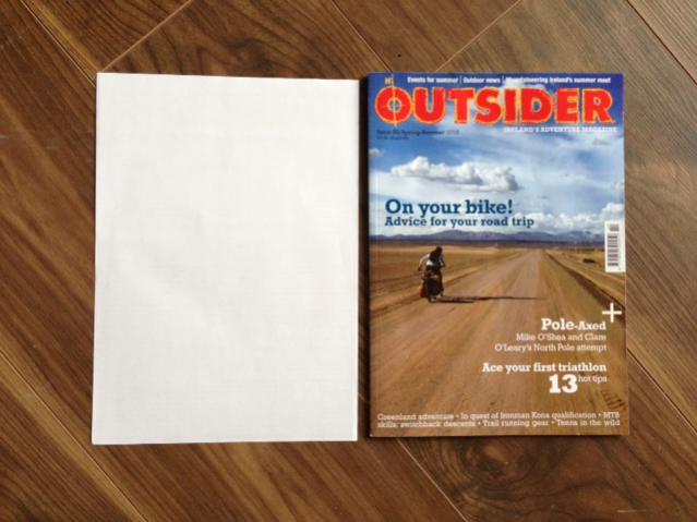

I cant explain how bad the printing is. I'll photocopy something and photograph the original and the copy so you can see

ok. tell me please how much ink is showing on your screen monitor??
Also please take rubbers out. perform head clean and try to print nozzle test page.

Believe it or not, this almost white page is a best quality colour photocopy of the magazine beside it.

they all say full to the top, do I take out the big or the small rubbers? I'm nearly afraid to do a head clean since that seemed to cause the problems on the other printer this morning.
take them out completely.

Thanks Paul, it was the rubbers causing the problem. I remove them and did a clean and a test print as you advised and I got something on the page. I had to clean and print again to get correct results.
However, after printing 4-5 proper images I then got an image that was just yellow, removing the rubbers and cleaning again fixed this immediately.
Thanks again for all your help

Do you have the small funnels that came with your cartridges installed? The Brother cartridges do not like the bungs in - they do supply little flying saucer shaped funnels that are designed to be left in the holes. I think bungs are necessary on epson cartridges as they are gravity fed, I believe the Brother sucks the ink through and hence need to be open to the air.
