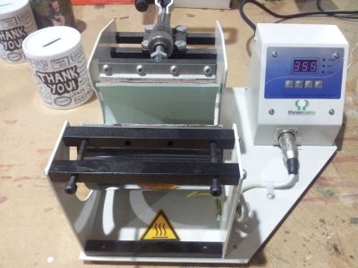

We are using a Ricoh printer and here is the press....
[ATTACH=CONFIG]1250[/ATTACH]
Many Thanks
Tom

Well if you are happy with the results then that is what really matters. 350/370F is close to 180C (and all presses float a bit around their set temperature). I still feel that 280 secs is a bit long to have to press for for a quality result. I would still have thought half that time should have given acceptable transfer from most papers to most mugs.
