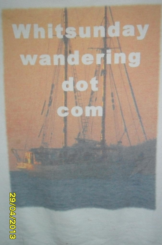

You can coat cotton fabric. I have seen tuat you can get greqt results. But i only saw it on the photos so dont know how it perdorm in washing machine etc...
It is possible but you have to really saturate the cotton and make sure it is dry before sublimating. You need to realise you are sublimating the polyester 'stuff' that is saturated into the cotton - it is impossible to sublimate the cotton itself.
The results are colourful, about like you get on a 50/50 cotton/poly material - maybe a bit brighter really. If you do it right it will not wash out, well, so far my favourite cotton shirt has survived about 100 hot machine washes with detergent and tumble drying and is good as new. Better than any JPSS heat transfers, and better than DTG prints I've seen.
BUT !!!!
It is time consuming. It is hit and miss. If you forget how you got a great result you may take months to reproduce the technique :-(
Definitely not something I would advise for commercial application, but for personal use I print DyeSub into treated cotton as my preference when I need a cotton shirt.[ATTACH=CONFIG]1883[/ATTACH]
This shirt was washed in hot, hot water immediately after pressing and had been horribly abused after that for many washes. It still looks pretty well the same and is worn and washed a couple of times a week.
