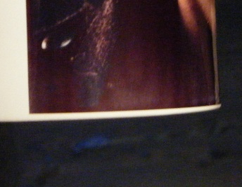

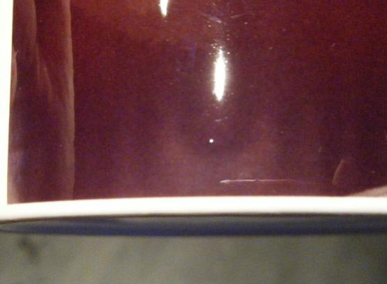

just an update. I have printed some more mugs from another box with same results.. here are the pics.. same area again.
[ATTACH=CONFIG]1327[/ATTACH] [ATTACH=CONFIG]1328[/ATTACH]
First one i printed with top of mug at the top.
Second i turned mug upside down and problem is in same area.. Has to be mugs..
