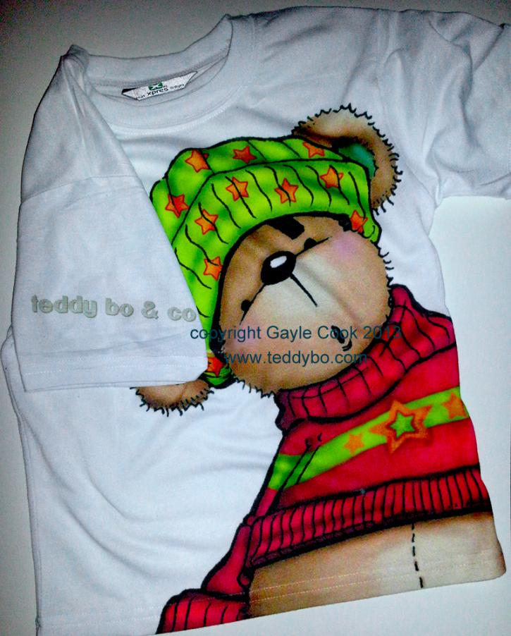

Some of the 'Aloha' ones look as if a giant press has just done the whole front as it's 'bled' through into the inside back of the jumper....under where you would have the size label!!! They're not finished the same way as the all over printing ones that I've seen before.
I've printed on children's t'shirts with A3, it creates a great impact....I am going to be creating a 'patterned' look over some of the t-shirts that will require a lot more work just be creating individual small transfers from one large sheet that I'll randomly place over the t-shirts etc....if it was just to create a pattern you could try that?!?!?! This was age 7-8 I think!?!?!
[ATTACH=CONFIG]1542[/ATTACH]
