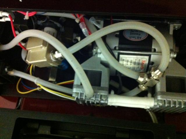

Consist of vacuum pump, filter and what i think is a large capacitor . Please Note that the filter needs to be emptied once in a while. I've done 12 cases and not a drop yet. White tube is actually the exhaust from what i believe is the vacuum.

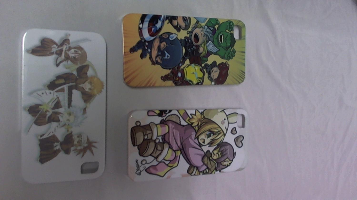

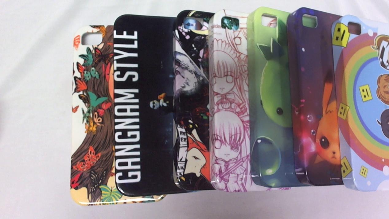

Obviously the most important part of a review is the quality of product it produces. Below are some photos of my finished I phone 4 cases which i made. Some are terrible as this is my first time however you can definitely tell i got better quickly.
[ATTACH=CONFIG]1714[/ATTACH][ATTACH=CONFIG]1711[/ATTACH][ATTACH=CONFIG]1712[/ATTACH][ATTACH=CONFIG]1713[/ATTACH]
This was my first attempt. The far left one i pressed at 190 C for 6 mins Came out horrible. Blurry and not imprinted at all. The other two turned out a lot better however there was some type of discoloration across the top portion of the case and not the bottom. After some though i realized it was because air was trapped where the camera hole was and so i made sure to fix it on next batch.
[ATTACH=CONFIG]1718[/ATTACH][ATTACH=CONFIG]1715[/ATTACH][ATTACH=CONFIG]1716[/ATTACH][ATTACH=CONFIG]1717[/ATTACH]
Attempted two. Came out a lot better. I wanted to see what a person would look like however totally forgot to consider resolution and it turned very blurry. Also it was upside down....
[ATTACH=CONFIG]1722[/ATTACH][ATTACH=CONFIG]1719[/ATTACH][ATTACH=CONFIG]1720[/ATTACH][ATTACH=CONFIG]1721[/ATTACH]
Attempt three. Holy Moses it come out great... at least 2 did. BTW i didn't do 3 at a time. Did them individually bet they were all printed together. The 1st two look fantastic and my GF stole both.... The third one i forgot to set the timer and took it out too early. failed...
[ATTACH=CONFIG]1723[/ATTACH][ATTACH=CONFIG]1726[/ATTACH][ATTACH=CONFIG]1727[/ATTACH]
Last Attempt. Nailed it. These are extremely vivid and colorful. They are slightly darker then the originals and i will try and find a way to fix that. But the cases turned out great. They are fully wrapped and sleek to the touch.
[ATTACH=CONFIG]1724[/ATTACH][ATTACH=CONFIG]1725[/ATTACH]
Here are some pictures of the sides. Fully wrapped however must be pretty careful when sticking on the transfer paper. Need to do it a certain way which i will show in the video. i must say that at 500 USD this machine is quite good. Since i have no prior experience with sub units i don't really know if this is high quality product but i like what it makes. It is not limited to phone cases and can make a wide range of stuff like tshirts, glass things, rock things, mugs (12 at a time whoa), shot glasses, metal plates, normal plates etc.. The whole process of making one phone case is included in the video however if my horrible slurring of words fails to communicate what needs to be said, i have listed the process below.
