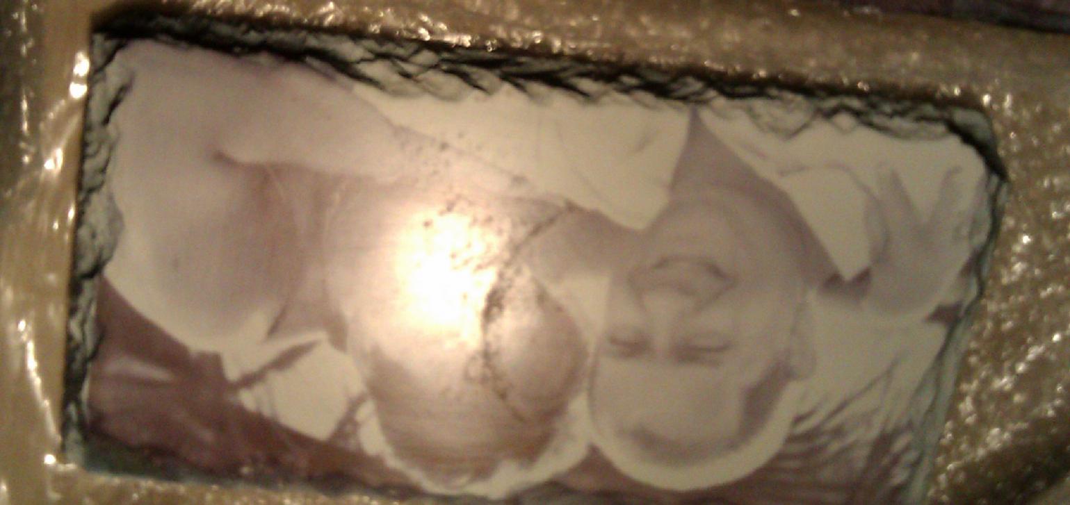

The matt ones I had were from Coralgraph, not happy with them at all. Will have to go through them and separate the duff ones.
As you can see on the first photo, there is a circular mark which wasn't obvious before printing. But when the light is on it, it's very obvious. The second photo is with a glossy slate from an old photo, so pleased with that one. The 3rd photo shows another slate I printed trying to get the blacks dark and resulted in areas of overcooking in the ladies' hair.
Any comments?
[ATTACH=CONFIG]1901[/ATTACH][ATTACH=CONFIG]1902[/ATTACH][ATTACH=CONFIG]1903[/ATTACH]
Any comments?
