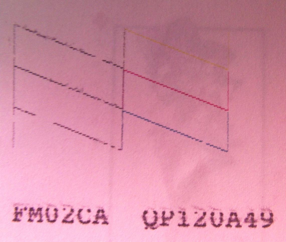

Just tried many of the things above and still nothing. I have attached an mage of what the test looks like just in case I have miss understood something.
[ATTACH=CONFIG]1906[/ATTACH]
